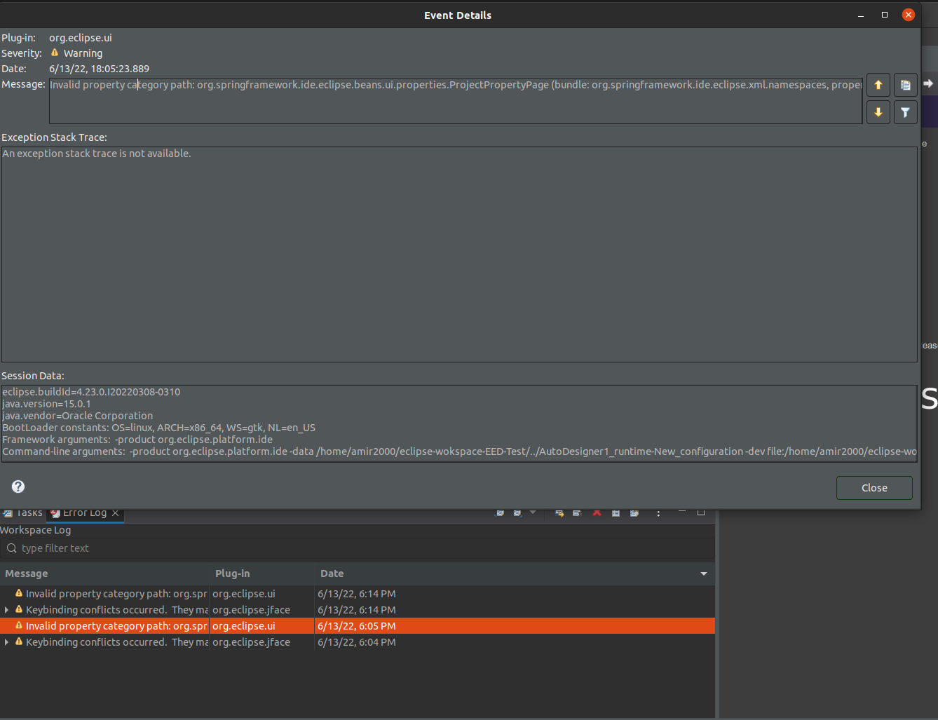

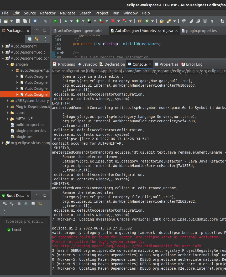

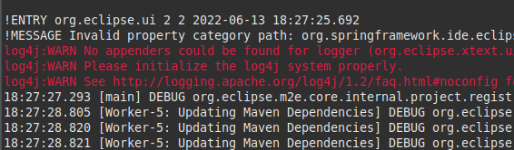

Hi everyone,
I have currently problems with creating a model.
I get the following errer message:
The selected wizard could not be started.
Plug-in "AutoDesigner1.editor" was unable to instantiate class "autoDesigner1.presentation.AutoDesigner1ModelWizard".
java.lang.reflect.InvocationTargetException
Here is the .log file:
!SESSION 2022-06-12 13:50:05.508 -----------------------------------------------
eclipse.buildId=4.23.0.I20220308-0310
java.version=16.0.1
java.vendor=Private Build
BootLoader constants: OS=linux, ARCH=x86_64, WS=gtk, NL=en_US
Framework arguments: -product org.eclipse.platform.ide
Command-line arguments: -product org.eclipse.platform.ide -data /home/amir2000/eclipse-wokspace-EED-Test/../AutoDesigner_runtime-New_configuration -dev file:/home/amir2000/eclipse-wokspace-EED-Test/.metadata/.plugins/org.eclipse.pde.core/New_configuration/dev.properties -os linux -ws gtk -arch x86_64 -consoleLog
!ENTRY org.eclipse.jface 2 0 2022-06-12 13:50:12.707
!MESSAGE Keybinding conflicts occurred. They may interfere with normal accelerator operation.
!SUBENTRY 1 org.eclipse.jface 2 0 2022-06-12 13:50:12.707
!MESSAGE A conflict occurred for CTRL+SHIFT+T:
Binding(CTRL+SHIFT+T,
ParameterizedCommand(Command(org.eclipse.jdt.ui.navigate.open.type,Open Type,
Open a type in a Java editor,
Category(org.eclipse.ui.category.navigate,Navigate,null,true),
org.eclipse.ui.internal.WorkbenchHandlerServiceHandler@7a7bd9a8,
,,true),null),
org.eclipse.ui.defaultAcceleratorConfiguration,
org.eclipse.ui.contexts.window,,,system)
ParameterizedCommand(Command(org.eclipse.lsp4e.symbolinworkspace,Go to Symbol in Workspace,
Category(org.eclipse.lsp4e.category,Language Servers,null,true),
org.eclipse.ui.internal.WorkbenchHandlerServiceHandler@72b6fa98,
,,true),null),
!MESSAGE A conflict occurred for ALT+SHIFT+R:
Binding(ALT+SHIFT+R,
ParameterizedCommand(Command(org.eclipse.jdt.ui.edit.text.java.rename.element,Rename - Refactoring ,
Rename the selected element,
Category(org.eclipse.jdt.ui.category.refactoring,Refactor - Java,Java Refactoring Actions,true),
org.eclipse.ui.internal.WorkbenchHandlerServiceHandler@1832b0f6,
,,true),null),
ParameterizedCommand(Command(org.eclipse.ui.edit.rename,Rename,
Rename the selected item,
Category(org.eclipse.ui.category.file,File,null,true),
org.eclipse.ui.internal.WorkbenchHandlerServiceHandler@6693818c,
,,true),null),
!ENTRY org.eclipse.ui 2 2 2022-06-12 13:51:02.210
!MESSAGE Invalid property category path: org.springframework.ide.eclipse.beans.ui.properties.ProjectPropertyPage (bundle: org.springframework.ide.eclipse.xml.namespaces, propertyPage: org.springframework.ide.eclipse.beans.ui.namespaces.projectPropertyPage)
