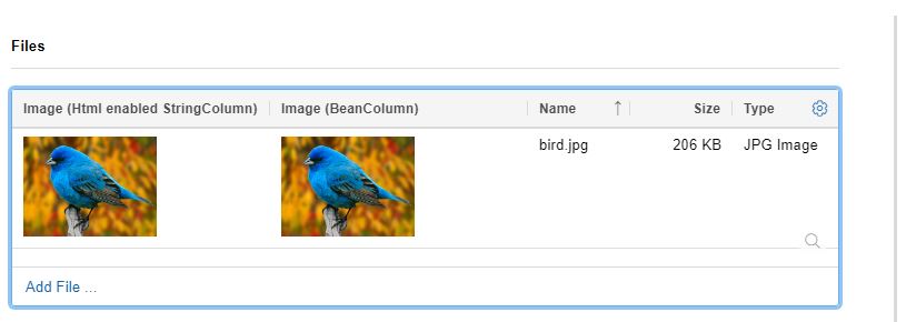

So i have a java Scout22 application and i wanted to know 2 things.
1) Is it possible to reduce the whitespace between the splitter and the other components. As you can see in picture 1 the whitespace between the table and the splitter is really big. Is there a easy way to reduce that? We tried it with css but the result was not really working.

1) Add this to your tableField and parent GroupBox field: getConfiguredStatusVisible() set it to false. This area is reserved for status of field to display to user. Or change its position with getConfiguredStatusPosition().
Re: Resize the splitter padding & Intelij plugin not working correctly [message #1852434 is a reply to message #1852431] Mon, 16 May 2022 09:08 Go to previous messageGo to next message
Hi Luka,
Thank you for your answer. I tried it out and it worked :)
