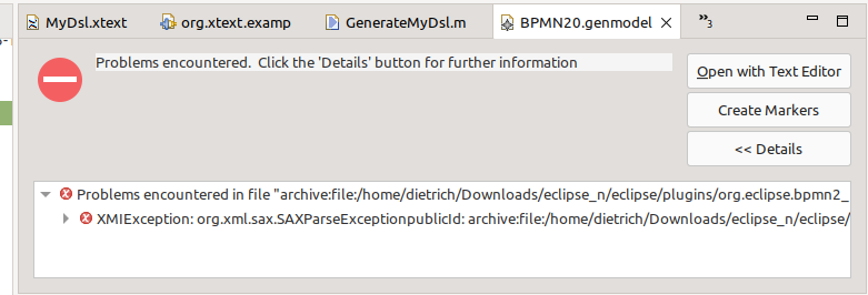

i get the same error when opening the genmodel with genmodel editor.
so the genmodel file seems to be broken.
you should contact the bpmn team
index.php/fa/42063/0/
this is the bad commit
https://git.eclipse.org/c/bpmn2/org.eclipse.bpmn2.git/commit/org.eclipse.bpmn2/model/BPMN20.genmodel?id=7f93282cd3cc31a795a7d9dec149fe1fe99503f8
patch would look like
https://git.eclipse.org/r/c/bpmn2/org.eclipse.bpmn2/+/193347
i assume you can import plugin as source and patch locally to continue

Thanks a lot, Christian, that was exactly the problem.
I downloaded the genmodel you have fixed, and incorporated into the jar org.eclipse.bpmn2_1.5.1.Final-v20200903-1545, and it works.
I was going crazy :-)
