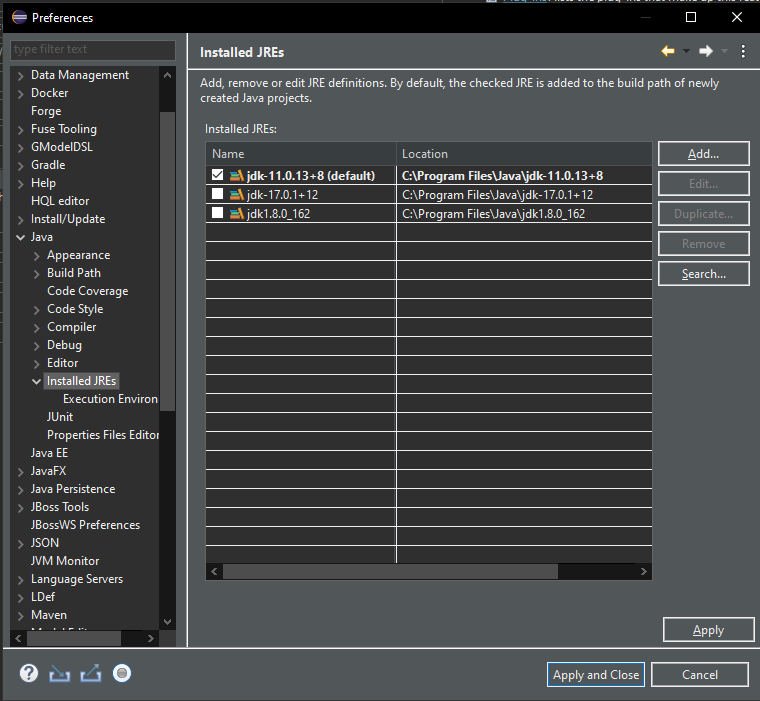

1) Installed JREs:
index.php/fa/41917/0/
the default is 11.0.13

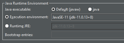

2) Run Configuration:
index.php/fa/41918/0/

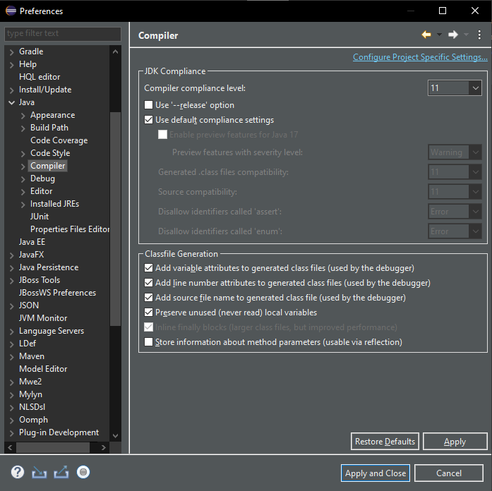

4) Compiler:
index.php/fa/41920/0/
as you can see, the compliance is always set for java 11...
