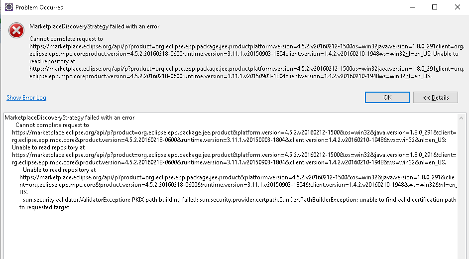

Below error is thrown when we try to access Marketplace. Have tried exporting the certificate from marketplace link and adding it to the JRE folder. Tried in all 3 network connections possible like Direct, Native and Manual. Also, tried adding -Djava.net.preferIPv4Stack=true in the INI file. Tried different versions of Eclipse and all are failing with the same error. Please suggest any other possible resolutions.
MarketplaceDiscoveryStrategy failed with an error
Cannot complete request to https://marketplace.eclipse.org/api/p?product=org.eclipse.epp.package.jee.product&platform.version=4.5.2.v20160212-1500&os=win32&java.version=1.8.0_291&client=org.eclipse.epp.mpc.core&product.version=4.5.2.20160218-0600&runtime.version=3.11.1.v20150903-1804&client.version=1.4.2.v20160210-1948&ws=win32&nl=en_US: Unable to read repository at https://marketplace.eclipse.org/api/p?product=org.eclipse.epp.package.jee.product&platform.version=4.5.2.v20160212-1500&os=win32&java.version=1.8.0_291&client=org.eclipse.epp.mpc.core&product.version=4.5.2.20160218-0600&runtime.version=3.11.1.v20150903-1804&client.version=1.4.2.v20160210-1948&ws=win32&nl=en_US.
sun.security.validator.ValidatorException: PKIX path building failed: sun.security.provider.certpath.SunCertPathBuilderException: unable to find valid certification path to requested target

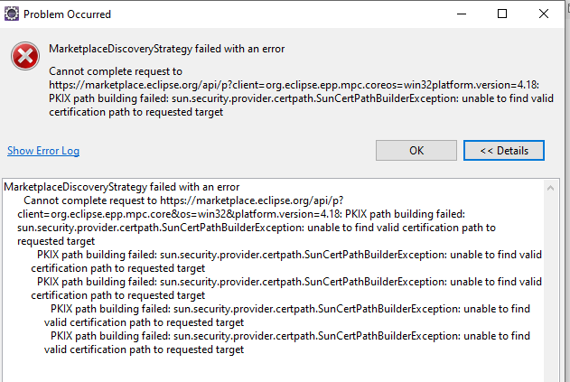

Multiple Eclipse versions have been tried and we are getting the same error even in the latest version of Eclipse. Java/Eclipse versions does not seem to be an issue here. Attaching the screenshot and error from latest Java version & 2021 Eclipse version.
Cannot complete request to https://marketplace.eclipse.org/api/p?client=org.eclipse.epp.mpc.core&os=win32&platform.version=4.18: PKIX path building failed: sun.security.provider.certpath.SunCertPathBuilderException: unable to find valid certification path to requested target
  • Attachment: Error.png
    (Size: 44.21KB, Downloaded 640 times)
Re: Unable to connect to Eclipse Marketplace [message #1851468 is a reply to message #1851463] Wed, 06 April 2022 06:53 Go to previous messageGo to next message
The query string here suggests you are using Eclipse 4.18. In any case, this problem is caused by missing cacerts. It might be the case that you are in a corporate environment where your proxy injects certificates into the communication stream that are not know to the Java runtime you are using, like in this case:
https://bugs.eclipse.org/bugs/show_bug.cgi?id=578341#c23
Adding the certificate to your certificate store is the only way to fix the problem
