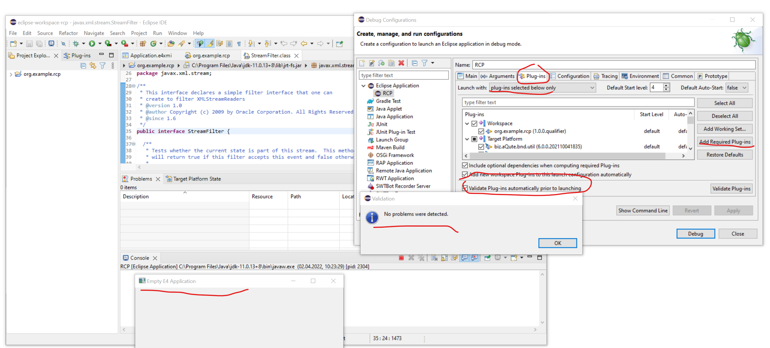

I'm not sure what you mean by "work well". Using a current Mac with the current release of Eclipse with JDK 17 (or any other JDK I've tried) using the default settings
for a Hello World RCP application, results in the errors I've already described. I've so far been unable to resolve some of the errors, but not to get the Hello World
application to launch. This is not what I mean by "working".
Since old versions of the Eclipse IDE won't even start on relatively recent Mac computers, for seemingly trivial reasons, like being unable to find the graphicsContext,
I suppose it might be pointless to develop using old versions of the RCP platform. But it's thrown everything into confusion and doubt.
There is of course a difference between "supported" and "working". Ideally, I'd like both. Currently, I have a "supported" system, but not working. If I have to choose,
I'll take "working" but "not supported".
I suppose if I keep working at it, I might learn enough to work around the IDE's ... misbehavior. If there's anyone else still trying to do RCP application
development (for e4), I assume that must be what they are doing. That is an option to consider, but combined with what I personally find to be a
baroque and awkward UX of the Eclipse IDE, it's a depressing prospect.
Since the app won't launch and the Problems pane shows no problem, I don't think a screen shot would be helpful.
