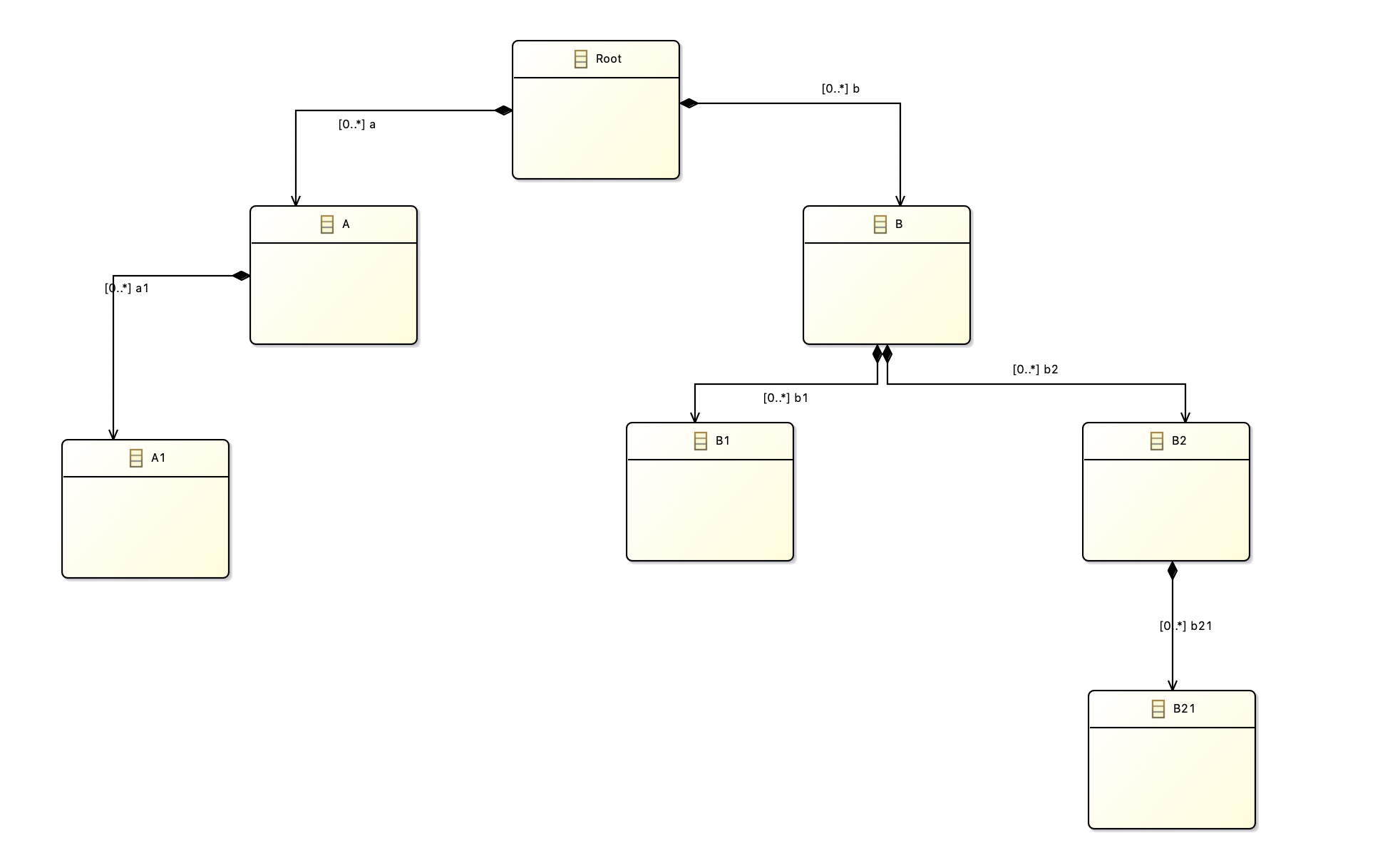

I would like to store in an array all the references leading from one object to another, thus getting the path (in terms of reference names).
Let us say that this would be the metamodel:
index.php/fa/41687/0/
And I would like to find the path from Root to B21. The path would be: b.b2.b21
[Updated on: Mon, 21 February 2022 18:02] by Moderator
Re: Find the path between two classes [message #1850221 is a reply to message #1850214] Tue, 22 February 2022 01:52 Go to previous messageGo to next message
I suggest looking at the implementation of EcoreUtil.getRelativeURIFragmentPath. In general, if an object's eContainer() != null then org.eclipse.emf.ecore.EObject.eContainmentFeature() will be != null and you can get the name of the reference from that.
