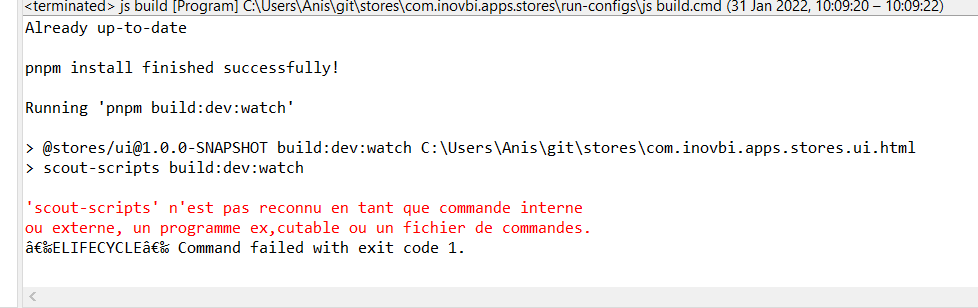

When I create a new helloword scout projet and try to lauch it ( version 22 beta ) a message error is raised :
index.php/fa/41608/0/

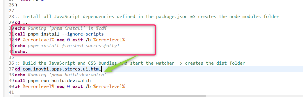

I fix it by changing the build.cmd file like follow :
index.php/fa/41609/0/

What exactly did you change in the build.cmd file? What was the value before and after your modification?
The 'pnpm install' should be executed in the root directory of your project (the directory that contains the pnpm-workspace.yaml file) while the 'pnpm run build:dev:watch' should be executed in the directory of your *.ui.html module.

Hello ,
I moved the red noticed part where the arrow points to in order to fix the issue and gets the nodes_modules created under the ui.html module and not under the parent.

Hi Anis
Ah ok, thank you. Now I got your change :)
Unfortunately I could not reproduce your error. I just created a new helloworld project using Eclipse 2022-03 M1 (4.23.0 M1) which used the Scout version 22.0.0-beta.5. Using this version the js build and application startup runs successfully.
Did you use another beta build? If yes: Could you please recreate the project using 22.0.0-beta.5? Does it work then?
If this does not help, could you please post the full log output. Especially the directories are interesting. Basically it should be correct to execute the pnpm install in the root directory and the build:dev:watch in the ui module.
Could you please also post the content of your pnpm-workspace.yaml in the root directory?
