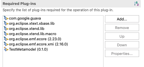

I am trying to generate some text from a model using Xtend. In order to do that, I have followed the following steps (all in a runtime instance):
1. Create metamodel (TestMetamodel)
2.Create a dynamic instance (Root.xmi)
2. Create an Xtend project, add all the dependencies
This is how they look: index.php/fa/41363/0/

You have a generated model (with generated interface Root) but you are loading an EPackage dynamically (presumably the same model you used to generate Root) and using that to load your instance, but then you are hoping the instance will conform to your generated model instead of your dynamic model. I'd suggest invoking Generate Test Code and looking at the generated XyzExample.java to see how to save and load instances of your generated model.

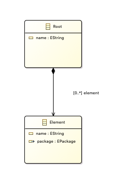

I was able to load the resource, but now I am encountering another issue for which I cannot find a solution in the example.
If I have the following meta model:
index.php/fa/41380/0/
When I do, Element.package, then I get a proxyURI (not resolved). I use EcoreUtil.resolve... to try and resolve it but no luck. I believe the issue stands that I need to also load the meta model of the Epackage that I am referring.
For that I only add this line of code:
resourceSet.getPackageRegistry().put(MetamodelToLoadPackage.eNS_URI, MetamodelToLoadPackage.eINSTANCE);
However, it is still not working. Is there something more that I need to add for the eProxyUri to be resolved?
By the way I have included this LoadedMetamodel in the dependencies in the META-INF.

So this is the eProxyURI: file:/Users/user/runtime-EclipseApplication/org.example.metamodel/model/loadedMetamodel.ecore#/
While this is the URI used to reference the Package:
<package href="../org.example.metamodel/model/loadedMetamodel.ecore#/
So they seem to be ok I guess?

You said that you have an unresolved proxy Element.package, if you look in the debugger what is the class of this object ? is it an instance of EPackage?
