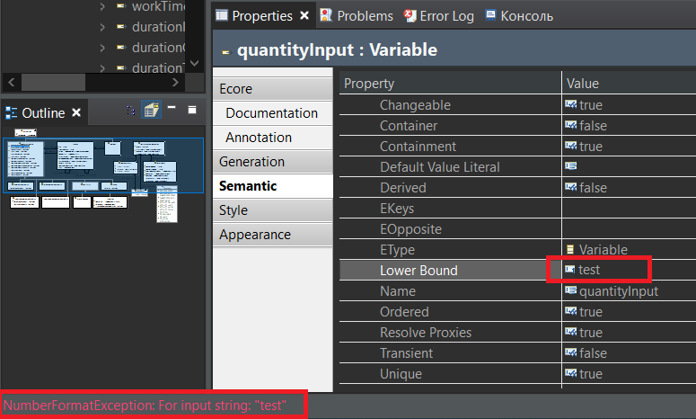

When I edit an attribute using legacy property editor I can see a format exception:
index.php/fa/41333/0/

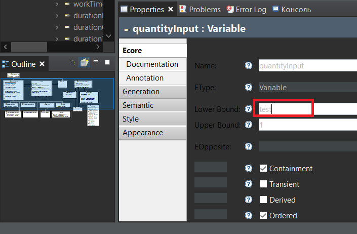

But when I edit the same attribute using EEF property editor, I can't see any exceptions:
index.php/fa/41334/0/
I can see only an entry in the error log:
org.eclipse.sirius.common.tools.api.interpreter.EvaluationException: An error has appeared during the evaluation of an expression:
Expression: aql:input.emfEditServices(self).setValue(eStructuralFeature, newValue)
Diagnostic: Diagnostic ERROR source=org.eclipse.acceleo.query code=0 setValue(Object=EClassifier=EditSupport,Object=EClassifier=EStructuralFeature,Object=EClassifier=EJavaObject) with arguments [org.eclipse.sirius.properties.core.internal.EditSupportSpec@807dd28, org.eclipse.emf.ecore.impl.EAttributeImpl@6253e59a (name: lowerBound) (ordered: true, unique: true, lowerBound: 0, upperBound: 1) (changeable: true, volatile: false, transient: false, defaultValueLiteral: null, unsettable: false, derived: false) (iD: false), test] failed:
	For input string: "test" data=[org.eclipse.acceleo.query.runtime.AcceleoQueryEvaluationException: setValue(Object=EClassifier=EditSupport,Object=EClassifier=EStructuralFeature,Object=EClassifier=EJavaObject) with arguments [org.eclipse.sirius.properties.core.internal.EditSupportSpec@807dd28, org.eclipse.emf.ecore.impl.EAttributeImpl@6253e59a (name: lowerBound) (ordered: true, unique: true, lowerBound: 0, upperBound: 1) (changeable: true, volatile: false, transient: false, defaultValueLiteral: null, unsettable: false, derived: false) (iD: false), test] failed:
	For input string: "test"]
Target URI Fragment: platform:/resource/...
Target: org.eclipse.emf.ecore.impl.EReferenceImpl@3462ae9f (name: quantityInput) (ordered: true, unique: true, lowerBound: 0, upperBound: 1) (changeable: true, volatile: false, transient: false, defaultValueLiteral: null, unsettable: false, derived: false) (containment: true, resolveProxies: true)
	at org.eclipse.sirius.common.acceleo.aql.business.internal.AQLSiriusInterpreter.evaluate(AQLSiriusInterpreter.java:203)
	at org.eclipse.sirius.tools.internal.interpreter.SessionInterpreter.evaluate(SessionInterpreter.java:179)
	at org.eclipse.sirius.common.tools.api.interpreter.IInterpreter.evaluateEObject(IInterpreter.java:180)
	at org.eclipse.sirius.business.internal.logger.RuntimeLoggerInterpreterImpl.evaluateEObject(RuntimeLoggerInterpreterImpl.java:106)
	at org.eclipse.sirius.business.internal.helper.task.operations.ChangeContextTask.execute(ChangeContextTask.java:60)
	at org.eclipse.sirius.business.internal.helper.task.ExecuteToolOperationTask.executeTask(ExecuteToolOperationTask.java:119)
	at org.eclipse.sirius.business.internal.helper.task.ExecuteToolOperationTask.executeTask(ExecuteToolOperationTask.java:126)
	at org.eclipse.sirius.business.internal.helper.task.ExecuteToolOperationTask.execute(ExecuteToolOperationTask.java:108)
	at org.eclipse.sirius.business.api.helper.task.TaskExecutor.execute(TaskExecutor.java:66)
	at org.eclipse.sirius.tools.api.command.SiriusCommand.doExecute(SiriusCommand.java:82)
	at org.eclipse.emf.transaction.RecordingCommand.execute(RecordingCommand.java:135)
	at org.eclipse.sirius.properties.core.internal.SiriusToolServices.executeOperation(SiriusToolServices.java:72)
	at java.base/jdk.internal.reflect.NativeMethodAccessorImpl.invoke(NativeMethodAccessorImpl.java:62)
	at java.base/jdk.internal.reflect.DelegatingMethodAccessorImpl.invoke(DelegatingMethodAccessorImpl.java:43)
	at java.base/java.lang.reflect.Method.invoke(Method.java:566)
	at org.eclipse.acceleo.query.runtime.impl.JavaMethodService.internalInvoke(JavaMethodService.java:162)
	at org.eclipse.acceleo.query.runtime.impl.AbstractService.invoke(AbstractService.java:135)
	at org.eclipse.acceleo.query.runtime.impl.EvaluationServices.callService(EvaluationServices.java:129)
	at org.eclipse.acceleo.query.runtime.impl.EvaluationServices.call(EvaluationServices.java:172)
	at org.eclipse.acceleo.query.runtime.impl.EvaluationServices.callOrApply(EvaluationServices.java:208)
	at org.eclipse.acceleo.query.parser.AstEvaluator.caseCall(AstEvaluator.java:189)
	at org.eclipse.acceleo.query.ast.util.AstSwitch.doSwitch(AstSwitch.java:119)
	at org.eclipse.emf.ecore.util.Switch.doSwitch(Switch.java:53)
	at org.eclipse.emf.ecore.util.Switch.doSwitch(Switch.java:69)
	at org.eclipse.acceleo.query.parser.AstEvaluator.eval(AstEvaluator.java:109)
	at org.eclipse.acceleo.query.runtime.impl.QueryEvaluationEngine.eval(QueryEvaluationEngine.java:52)
	at org.eclipse.sirius.common.acceleo.aql.business.internal.AQLSiriusInterpreter.evaluateExpression(AQLSiriusInterpreter.java:218)
	at org.eclipse.sirius.tools.internal.interpreter.SessionInterpreter.evaluateExpression(SessionInterpreter.java:161)
	at org.eclipse.sirius.properties.core.api.SiriusInterpreter.evaluateExpression(SiriusInterpreter.java:65)
	at org.eclipse.eef.core.api.utils.EvalFactory$Eval.call(EvalFactory.java:205)
	at org.eclipse.eef.core.api.utils.EvalFactory$Eval.call(EvalFactory.java:182)
	at org.eclipse.eef.core.internal.controllers.EEFTextController.lambda$0(EEFTextController.java:76)
	at org.eclipse.sirius.ui.properties.internal.TransactionalEditingDomainContextAdapter$1.doExecute(TransactionalEditingDomainContextAdapter.java:120)
	at org.eclipse.emf.workspace.EMFCommandOperation.doExecute(EMFCommandOperation.java:119)
	at org.eclipse.emf.workspace.AbstractEMFOperation.execute(AbstractEMFOperation.java:150)
	at org.eclipse.core.commands.operations.DefaultOperationHistory.execute(DefaultOperationHistory.java:496)
	at org.eclipse.emf.workspace.impl.WorkspaceCommandStackImpl.doExecute(WorkspaceCommandStackImpl.java:208)
	at org.eclipse.emf.transaction.impl.AbstractTransactionalCommandStack.execute(AbstractTransactionalCommandStack.java:165)
	at org.eclipse.emf.transaction.impl.AbstractTransactionalCommandStack.execute(AbstractTransactionalCommandStack.java:219)
	at org.eclipse.sirius.ui.properties.internal.TransactionalEditingDomainContextAdapter.performModelChange(TransactionalEditingDomainContextAdapter.java:126)
	at org.eclipse.eef.core.internal.controllers.EEFTextController.updateValue(EEFTextController.java:68)
	at org.eclipse.eef.ide.ui.internal.widgets.EEFTextLifecycleManager.updateValue(EEFTextLifecycleManager.java:409)
	at org.eclipse.eef.ide.ui.internal.widgets.EEFTextLifecycleManager.lambda$1(EEFTextLifecycleManager.java:264)
	at org.eclipse.eef.common.ui.api.SWTUtils$2.focusLost(SWTUtils.java:71)
	at org.eclipse.swt.widgets.TypedListener.handleEvent(TypedListener.java:147)
	at org.eclipse.swt.widgets.EventTable.sendEvent(EventTable.java:89)
	at org.eclipse.swt.widgets.Display.sendEvent(Display.java:4213)
	at org.eclipse.swt.widgets.Widget.sendEvent(Widget.java:1037)
	at org.eclipse.swt.widgets.Widget.sendEvent(Widget.java:1061)
	at org.eclipse.swt.widgets.Widget.sendEvent(Widget.java:1042)
	at org.eclipse.swt.widgets.Control.sendFocusEvent(Control.java:2941)
	at org.eclipse.swt.widgets.Widget.wmKillFocus(Widget.java:1799)
	at org.eclipse.swt.widgets.Control.WM_KILLFOCUS(Control.java:5163)
	at org.eclipse.swt.widgets.Canvas.WM_KILLFOCUS(Canvas.java:421)
	at org.eclipse.swt.widgets.Control.windowProc(Control.java:4774)
	at org.eclipse.swt.widgets.Canvas.windowProc(Canvas.java:340)
	at org.eclipse.swt.widgets.Display.windowProc(Display.java:4931)
	at org.eclipse.swt.internal.win32.OS.PeekMessage(Native Method)
	at org.eclipse.swt.widgets.Display.readAndDispatch(Display.java:3625)
	at org.eclipse.e4.ui.internal.workbench.swt.PartRenderingEngine$5.run(PartRenderingEngine.java:1158)
	at org.eclipse.core.databinding.observable.Realm.runWithDefault(Realm.java:338)
	at org.eclipse.e4.ui.internal.workbench.swt.PartRenderingEngine.run(PartRenderingEngine.java:1047)
	at org.eclipse.e4.ui.internal.workbench.E4Workbench.createAndRunUI(E4Workbench.java:155)
	at org.eclipse.ui.internal.Workbench.lambda$3(Workbench.java:658)
	at org.eclipse.ui.internal.Workbench.createAndRunWorkbench(Workbench.java:557)
	at org.eclipse.ui.PlatformUI.createAndRunWorkbench(PlatformUI.java:154)
	at org.eclipse.ui.internal.ide.application.IDEApplication.start(IDEApplication.java:150)
	at org.eclipse.core.runtime.internal.adaptor.EclipseAppLauncher.runApplication(EclipseAppLauncher.java:137)
	at org.eclipse.core.runtime.internal.adaptor.EclipseAppLauncher.start(EclipseAppLauncher.java:107)
	at org.eclipse.core.runtime.adaptor.EclipseStarter.run(EclipseStarter.java:401)
	at org.eclipse.equinox.launcher.Main.invokeFramework(Main.java:657)
	at org.eclipse.equinox.launcher.Main.basicRun(Main.java:594)
	at org.eclipse.equinox.launcher.Main.run(Main.java:1447)
	at org.eclipse.equinox.launcher.Main.main(Main.java:1420)
Caused by: org.eclipse.acceleo.query.runtime.AcceleoQueryEvaluationException: setValue(Object=EClassifier=EditSupport,Object=EClassifier=EStructuralFeature,Object=EClassifier=EJavaObject) with arguments [org.eclipse.sirius.properties.core.internal.EditSupportSpec@807dd28, org.eclipse.emf.ecore.impl.EAttributeImpl@6253e59a (name: lowerBound) (ordered: true, unique: true, lowerBound: 0, upperBound: 1) (changeable: true, volatile: false, transient: false, defaultValueLiteral: null, unsettable: false, derived: false) (iD: false), test] failed:
	at org.eclipse.acceleo.query.runtime.impl.AbstractService.invoke(AbstractService.java:147)
	at org.eclipse.sirius.common.acceleo.aql.business.internal.AQLSiriusInterpreter.evaluate(AQLSiriusInterpreter.java:197)
	... 83 more
Caused by: java.lang.NumberFormatException: For input string: "test"
	at java.base/java.lang.NumberFormatException.forInputString(NumberFormatException.java:65)
	at java.base/java.lang.Integer.parseInt(Integer.java:652)
	at java.base/java.lang.Integer.valueOf(Integer.java:983)
	at org.eclipse.emf.ecore.impl.EcoreFactoryImpl.createEIntFromString(EcoreFactoryImpl.java:656)
	at org.eclipse.emf.ecore.impl.EcoreFactoryImpl.createFromString(EcoreFactoryImpl.java:142)
	at org.eclipse.emf.ecore.util.EcoreUtil.createFromString(EcoreUtil.java:3689)
	at org.eclipse.sirius.properties.core.internal.EditSupportSpec.setValue(EditSupportSpec.java:253)
	at org.eclipse.acceleo.query.runtime.impl.EOperationService.eOperationJavaInvoke(EOperationService.java:246)
	at org.eclipse.acceleo.query.runtime.impl.EOperationService.internalInvoke(EOperationService.java:199)
	... 94 more
Could you please improve it somehow? Is it possible to show a validation error?
