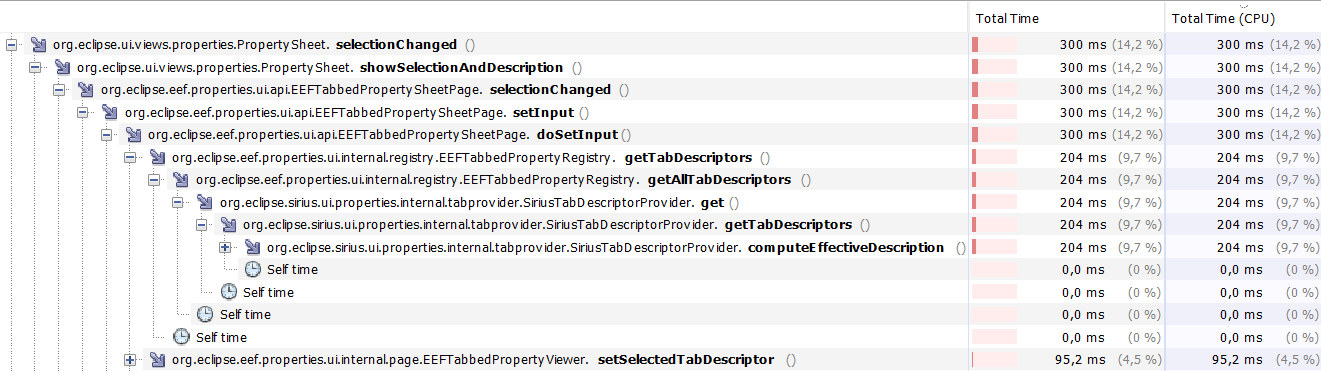

We have a large enough odesign-file (5 Mb) defining ~200 ViewExtensionDescription.
The problem is that the larger the file is the slower Sirius works. For example I open a diagram and click on its nodes and I experience a significant UI delay.
It seems that the delay is caused by SiriusTabDescriptorProvider:
index.php/fa/41300/0/
computeEffectiveDescription() method scans all ViewExtensionDescription in all selected viewpoints, converts them. It takes ~200 ms on each selection change.

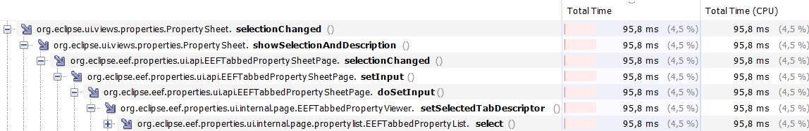

I replaced it by a custom TabDescriptorProvider. The only difference is that computeEffectiveDescription() method caches effectivePages:
index.php/fa/41301/0/
I guess that getTabDescriptors() is not show here because it works too fast and the sampler doesn't detect it.
The total time is decreased from 300 ms to 95 ms. It's a visible speed up.
For sure it's a bad solution because the cache should be invalidated. Some of the property forms are disappeared (they are defined in a separate odesign file loaded after cache is created). I think I can calculate the number of loaded viewExtensionDescriptions and update the cache if the number is changed.
