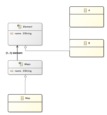

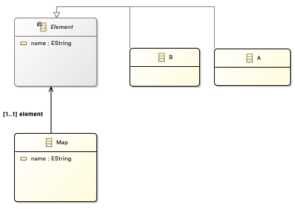

I have the following two metamodels:
This is the source metamodel: index.php/fa/41222/0/
And this is the target metamodel: index.php/fa/41223/0/
Up til now, I have written the following transformation in QVTo.

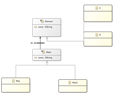

Because I have tried using abstract/inherit/disjunct in other cases and this one too . For Maps it works, but for Element no. Source metamodel as before:
index.php/fa/41224/0/
And the target metamodel:
index.php/fa/41225/0/
In this case I do use what you mentioned in the following code snippet:
