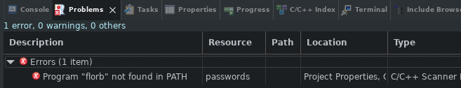

I also allocated a console for it and got [slightly edited]
florb -E -P -v -dD /home/dvavra/workspaces/2021-09/Passwords/
.metadata/.plugins/org.eclipse.cdt.managedbuilder.core/spec.cpp
Cannot run program "florb": Unknown reason
Error: Program "florb" not found in PATH

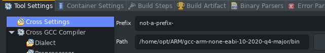

index.php/fa/41064/0/
For the g++ built-ins:
23:02:03 **** Running scanner discovery: CDT Cross GCC Built-in Compiler Settings ****
not-a-prefix-g++ -E -P -v -dD /home/dvavra/workspaces/2021-09/Passwords/.metadata/.plugins/org.eclipse.cdt.managedbuilder.core/spec.cpp
Cannot run program "not-a-prefix-g++": Unknown reason
Error: Program "not-a-prefix-g++" not found in PATH
PATH=[/home/opt/ARM/gcc-arm-none-eabi-10-2020-q4-major/bin:/home/dvavra/bin:/home/dvavra/.local/bin:/opt/perl/5.34.0/bin:/usr/local/sbin:/usr/local/bin:/usr/sbin:/usr/bin]
I would think you are getting a double prefix because you altered the
toolchain compiler commands.

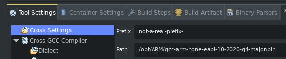

Such as when I changed the cross compile settings to

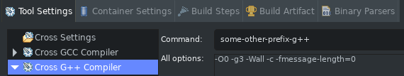

index.php/fa/41065/0/
and the compiler in the toolchain:
index.php/fa/41066/0/
I get:
23:20:14 **** Running scanner discovery: CDT Cross GCC Built-in Compiler Settings ****
not-a-real-prefix-some-other-prefix-g++ -E -P -v -dD /home/dvavra/workspaces/2021-09/Passwords/.metadata/.plugins/org.eclipse.cdt.managedbuilder.core/spec.cpp
Cannot run program "not-a-real-prefix-some-other-prefix-g++": Unknown reason
Error: Program "not-a-real-prefix-some-other-prefix-g++" not found in PATH
PATH=[/opt/ARM/gcc-arm-none-eabi-10-2020-q4-major/bin:/home/dvavra/bin:/home/dvavra/.local/bin:/opt/perl/5.34.0/bin:/usr/local/sbin:/usr/local/bin:/usr/sbin:/usr/bin]

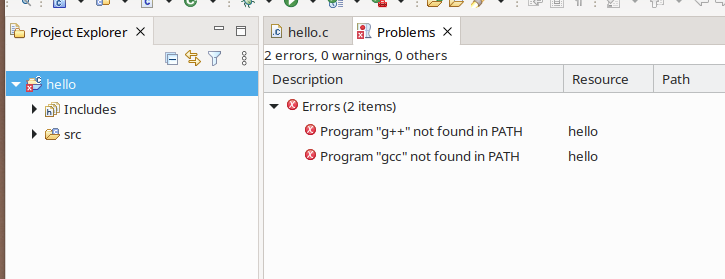

Take fresh Kubuntu 20.04LTS with Raspbian toolkit in /opt/raspbian/. Note that neither gcc nor g++ are there.
index.php/fa/41071/0/

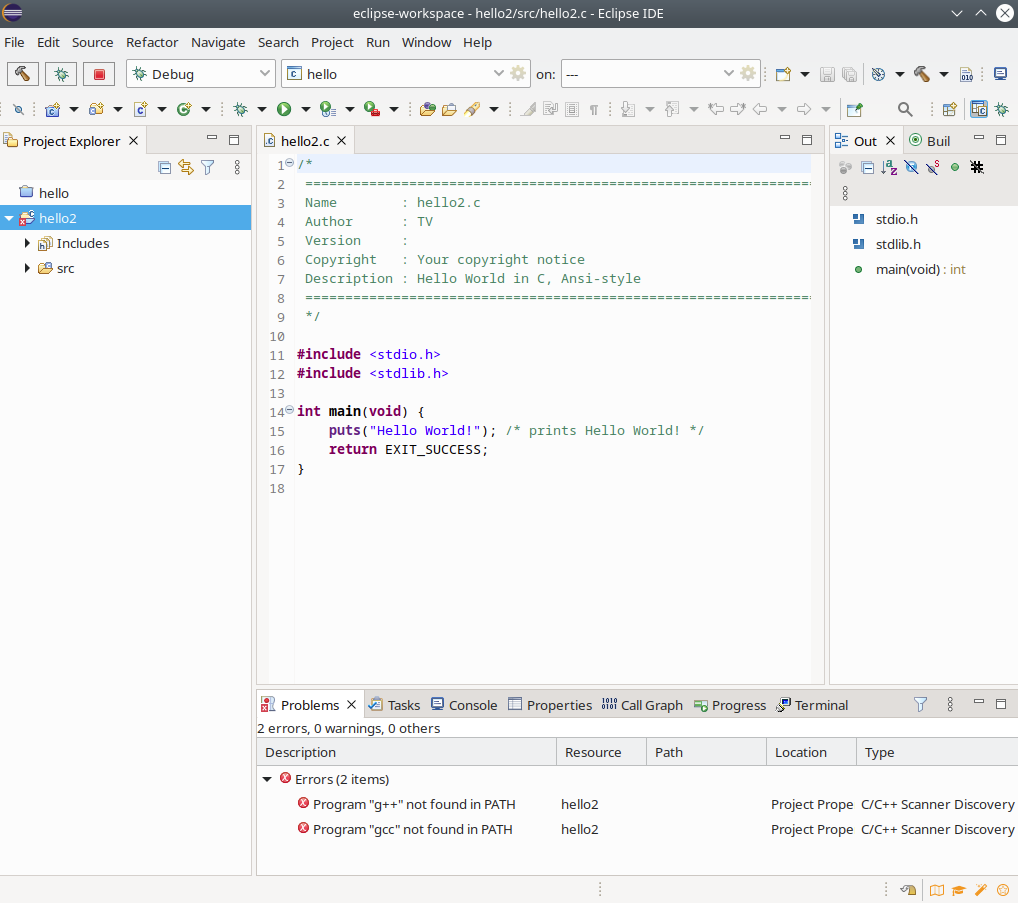

Select File -> New -> C/C++ Project, C Managed Build, name the project, select Hello World ANSI C and Cross GCC, three times Next. Set up cross compiler on the configuration screen (the toolkit is there):
index.php/fa/41072/0/
We get a fresh project with the error cross:
index.php/fa/41073/0/
Tauno Voipio

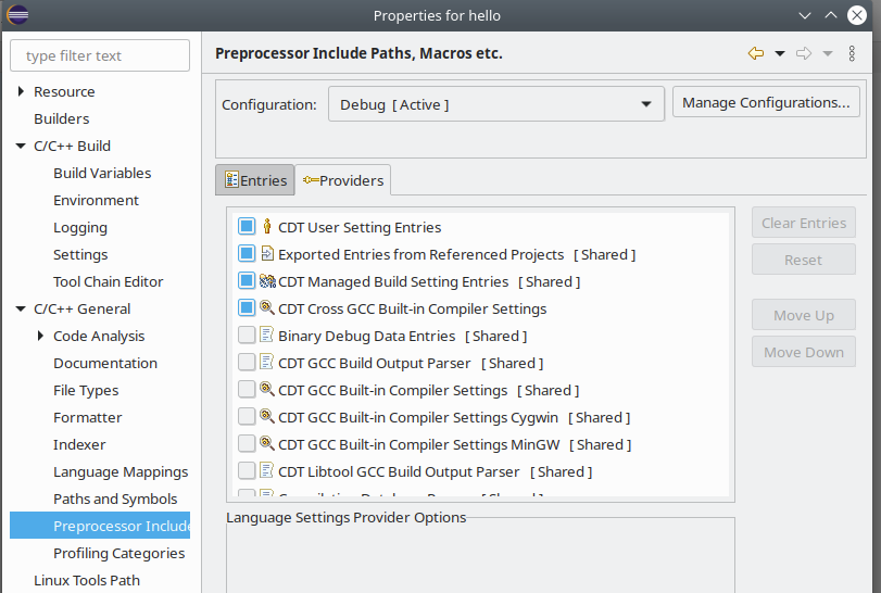

I found that the "normal" gcc built-in provider used with
the cross compile tool chain ignores the prefix and path.
You have to use the cross-compile provider.
Did you? You didn't show doing so.

Do you mean this:
index.php/fa/41074/0/
Tauno Voipio
Re: CDT complains of missing host gcc and g++ for a cross-compile [message #1845015 is a reply to message #1845014] Sat, 02 October 2021 20:54 Go to previous message
David VavraFriend
Messages: 1427
Registered: October 2012
Senior Member
Yes
