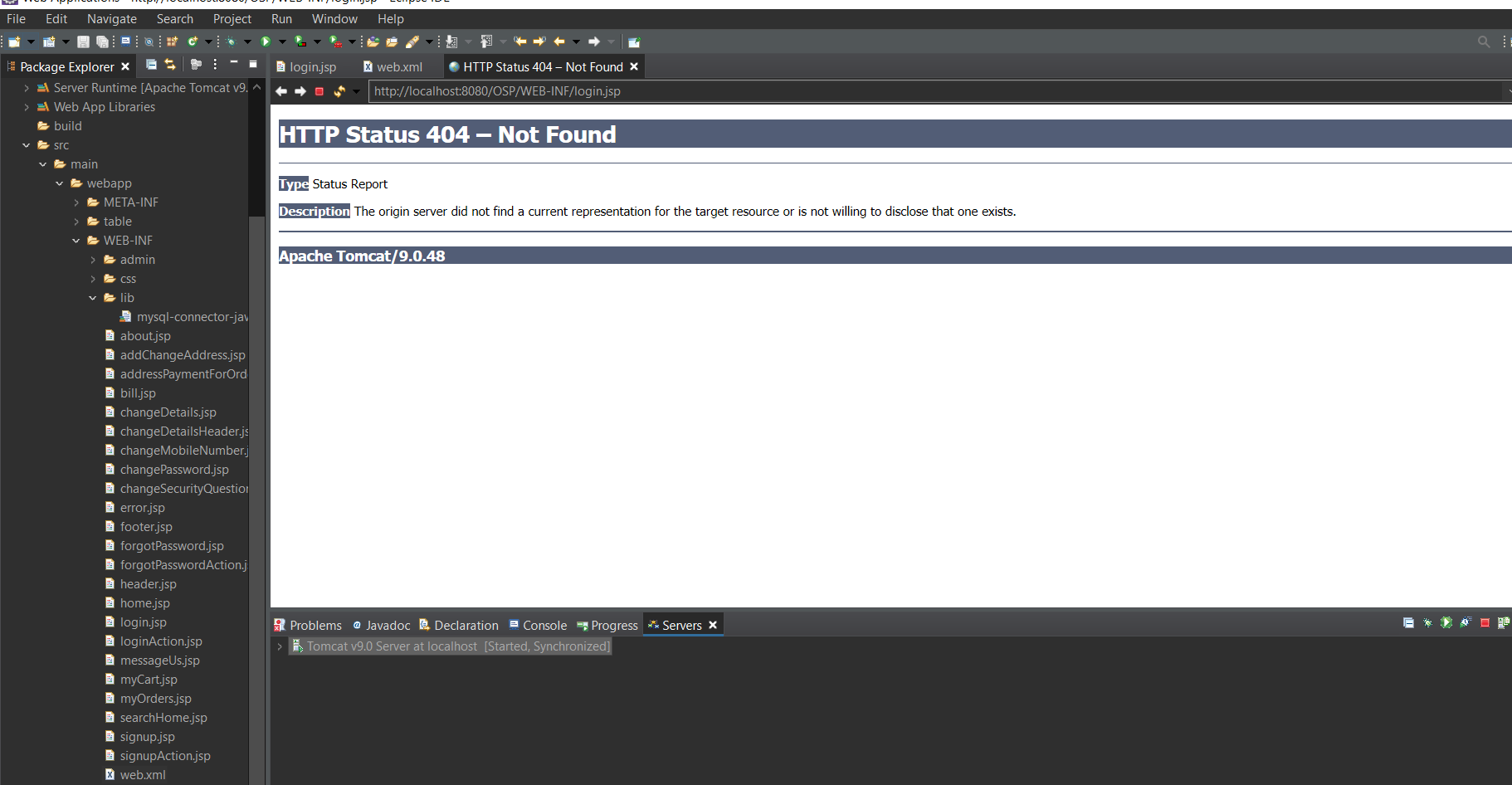

Re: still trying to get started [message #1842624 is a reply to message #1841927] Fri, 25 June 2021 12:38 Go to previous messageGo to next message
here is also my error message in web.xml file and I am stuck with it five days :(
schema_reference.4: Failed to read schema document 'platform:/plugin/org.eclipse.xsd/cache/www.w3.org/2001/
xml.xsd', because 1) could not find the document; 2) the document could not be read; 3) the root element of the
document is not <xsd:schema>.
and finally i got error in running my jsp project in apache tomcat server,
  • Attachment: Capture.PNG
    (Size: 92.97KB, Downloaded 303 times)
    (Size: 92.97KB, Downloaded 271 times)
Re: still trying to get started [message #1842633 is a reply to message #1842624] Fri, 25 June 2021 17:34 Go to previous message
Mumtahina, that should probably have been a separate thread, but you can not directly serve anything under WEB-INF to clients like a web browser. That's where you put private resources and class files--which you definitely don't want someone decompiling for secrets.
