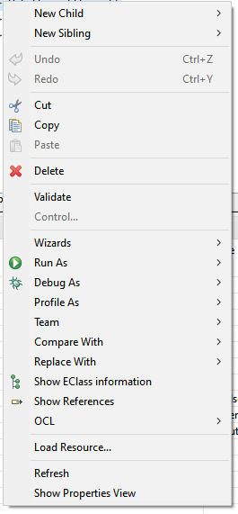

I have been trying to get my menu labels to appear when I right click in my diagram by following the example but it's not working no matter how much I play with it and follow the example. I am very lost at the moment trying to figure this out as I seem to be doing exactly what the example says to do.
I have my pop up menu defined and there is a group menu option in there defined as well so that it shows up at the root of the popup menu when I right click without any context:
index.php/fa/40500/0/
And then when I go ahead and right click on my diagram editor there isn't anything that shows up. I also checked the tree editor but nothing shows up there either.
index.php/fa/40501/0/
index.php/fa/40502/0/
There is this line in the page that you sent me: Note: If your VSM is in the runtime environment workspace to do dynamic development of your VSM, the changes are not systematically reflected in the menu. A selection change may be necessary (to rebuild the menu).
I am working in a runtime environment for the development of my editor so I have been refreshing the project, closing and opening it again as well as simply creating new models and nothing seems to change in the menu. Are there any other troubleshooting steps I can take to figure out why the example isn't working? Is there some sort of extension that I need to add to my runtime VSM to allow for the creation of these menus??
