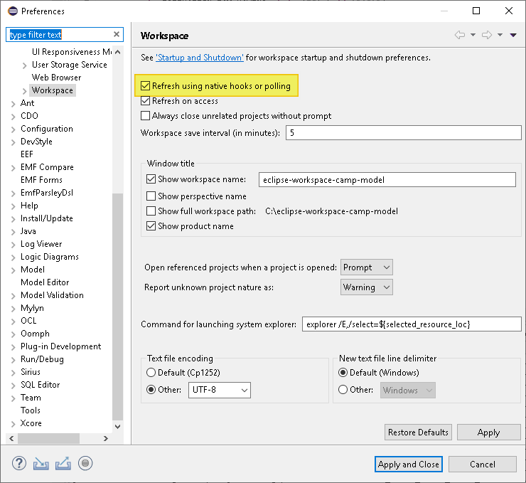

you may check auto refresh or refresh on access in your workspace preferences.

With the suggestion of Christian, I changed the refresh setting in eclipse.
It was only the option "Refresh on access" selected. Now I also selected another option "Refresh using native hooks or polling". Bingo, it works well with the third party git client now!!!! Thanks so much Christian.

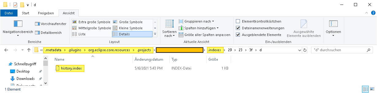

The "builder.state" file I could not find under .metadata folder and its sub folders. I only found some history.index files, which is under .metadata/.plugins/org.eclipse.core.resources/.project/<xtext project name>/.indexes, I don't think these files are generated by xtext.

The file is only there after you shutdown and before you start eclipse
