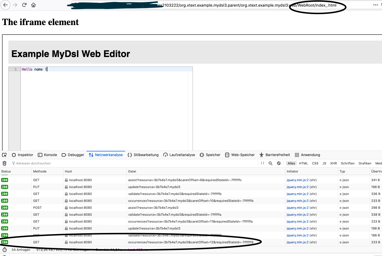

Re: xtext-services and iframe [message #1840982 is a reply to message #1840975] Thu, 29 April 2021 15:29 Go to previous messageGo to next message
unfortunately your code works on my machine perfectly fine
maybe this is a problem with special browsers like chrome or safari and restrictions about cross origin
or with the jquery and other versions
does the resource id and co change between the requests?
maybe you also can remote debug the server.
maybe xtext sevlet has a org.eclipse.xtext.web.server.InvalidRequestException$ResourceNotFoundException
this might be caused by session not working correct with the iframe
thus you may put your local html to the server too
[Updated on: Thu, 29 April 2021 16:02] by Moderator

Re: xtext-services and iframe [message #1840986 is a reply to message #1840982] Thu, 29 April 2021 16:39 Go to previous messageGo to next message
No it keeps the same resourceID which is the default start -80000000
Thats because it can't do the update and decrease by 1.
The strange thing is that the validator works in Firefox.
In the other Browsers (Opera, Chrome and Edge) i get the errors i mentioned in my previous posts.
Have you tested only with Firefox ?
Did you tested also with the rest of the Browsers?
Bests
[Updated on: Thu, 20 May 2021 10:56] by Moderator

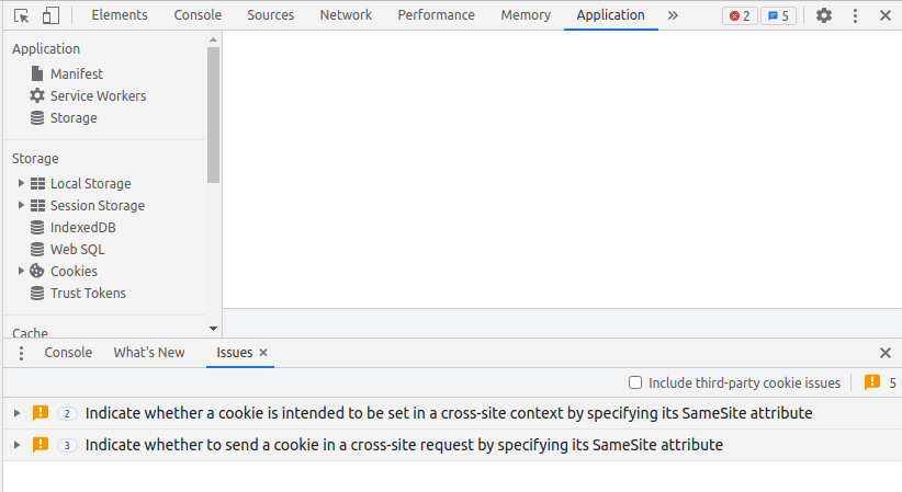

Re: xtext-services and iframe [message #1840992 is a reply to message #1840986] Fri, 30 April 2021 00:43 Go to previous messageGo to next message
The problem is that session is not working con chrome
Cause they don't like the iFrame and two servers thing you do.
index.php/fa/40425/0/
If you ship both files via the server chrome is fine
Did you try the stateless? The sendFullText (and clear the cache)
