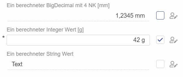

Hi André,
it worked like a charm and I didn't have to write a single line of JavaScript code.
I tried to use the @ModelVariant annotation, but for that I would have had to define a custom JavaScript implementation of the field. Maybe I used it incorrectly but instead I now used getConfiguredCssClass.
Here is a demo screenshot:
index.php/fa/40422/0/
Thanks again,
Nils
Re: Custom Field with additional state [message #1840994 is a reply to message #1840974] Fri, 30 April 2021 01:15 Go to previous message
Hi Nils
Your new field looks great, good job! :) You're right: the @ModelVariant is indeed only needed when you need to change the behavior of an existing JS widget or need to make changes to DOM of the widget. For that you must write JavaScript. For a lot of cases setting a CSS class and do some styling with pure CSS/LESS is sufficient.
