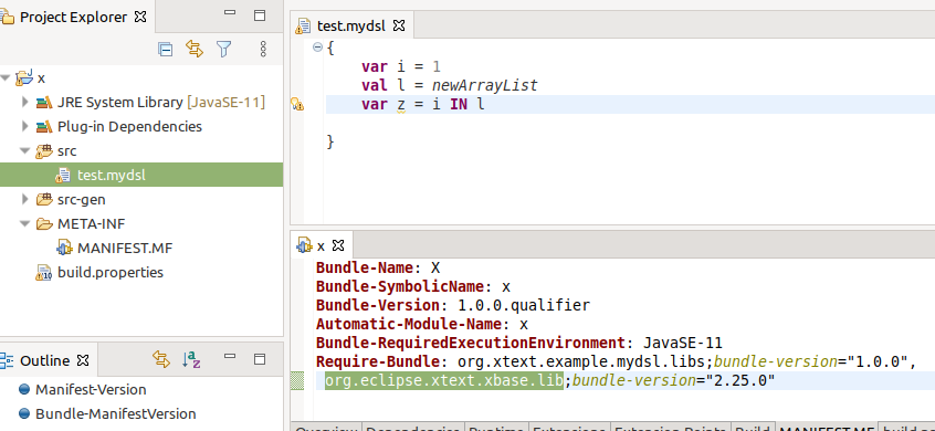

hi, i cannot reproduce. sure you added mydsl.libs to the cp of the model/example project?
index.php/fa/40235/0/

My bad, I was missing the mydsl.lib project in CP :(
Thanks for your time.
