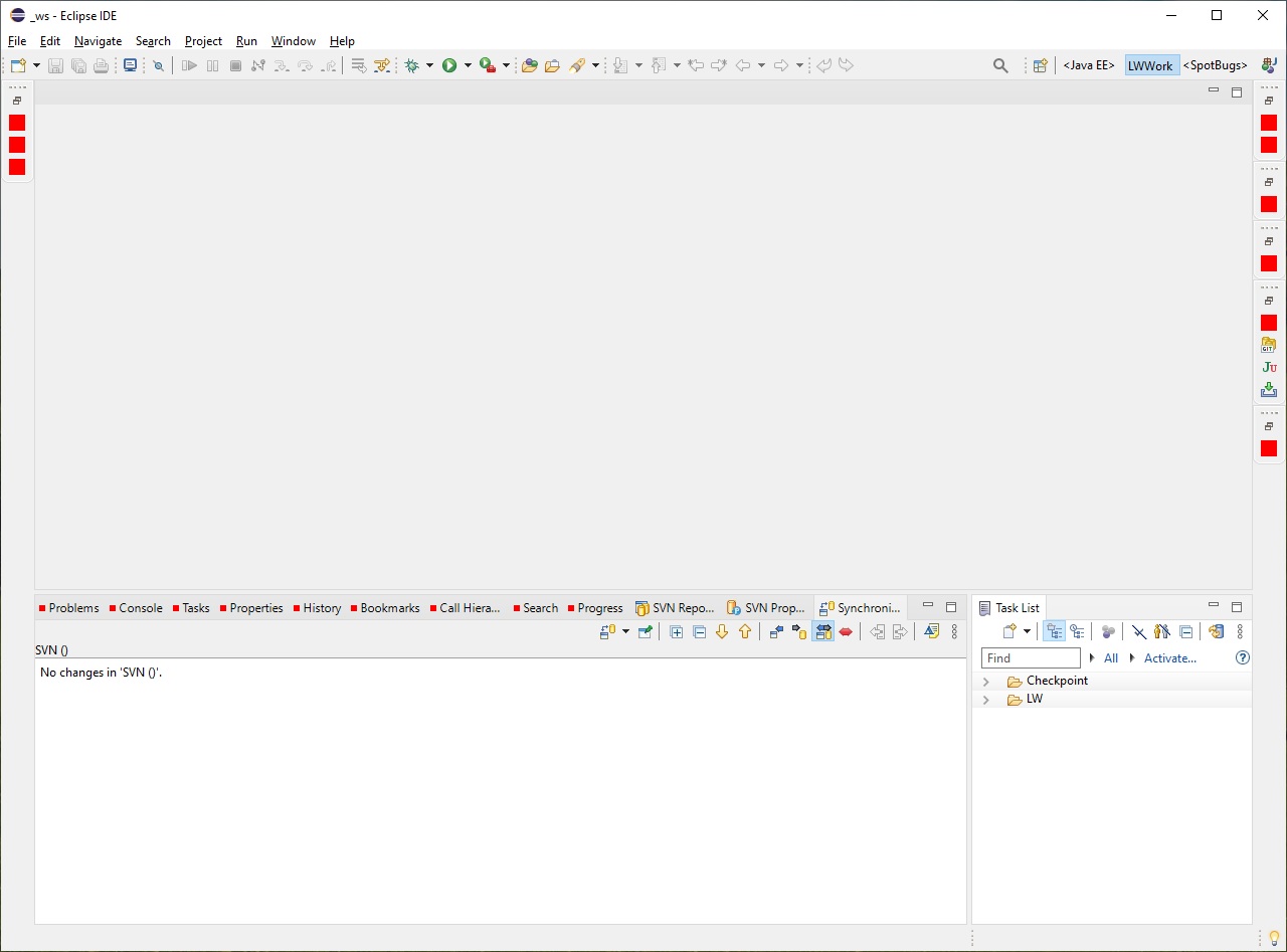

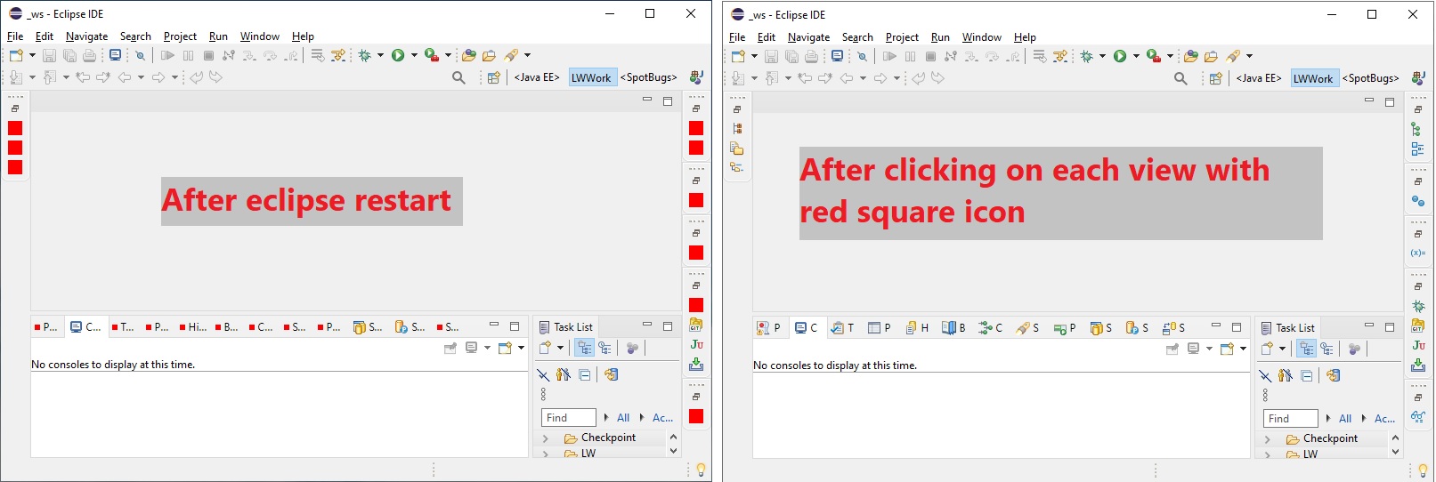

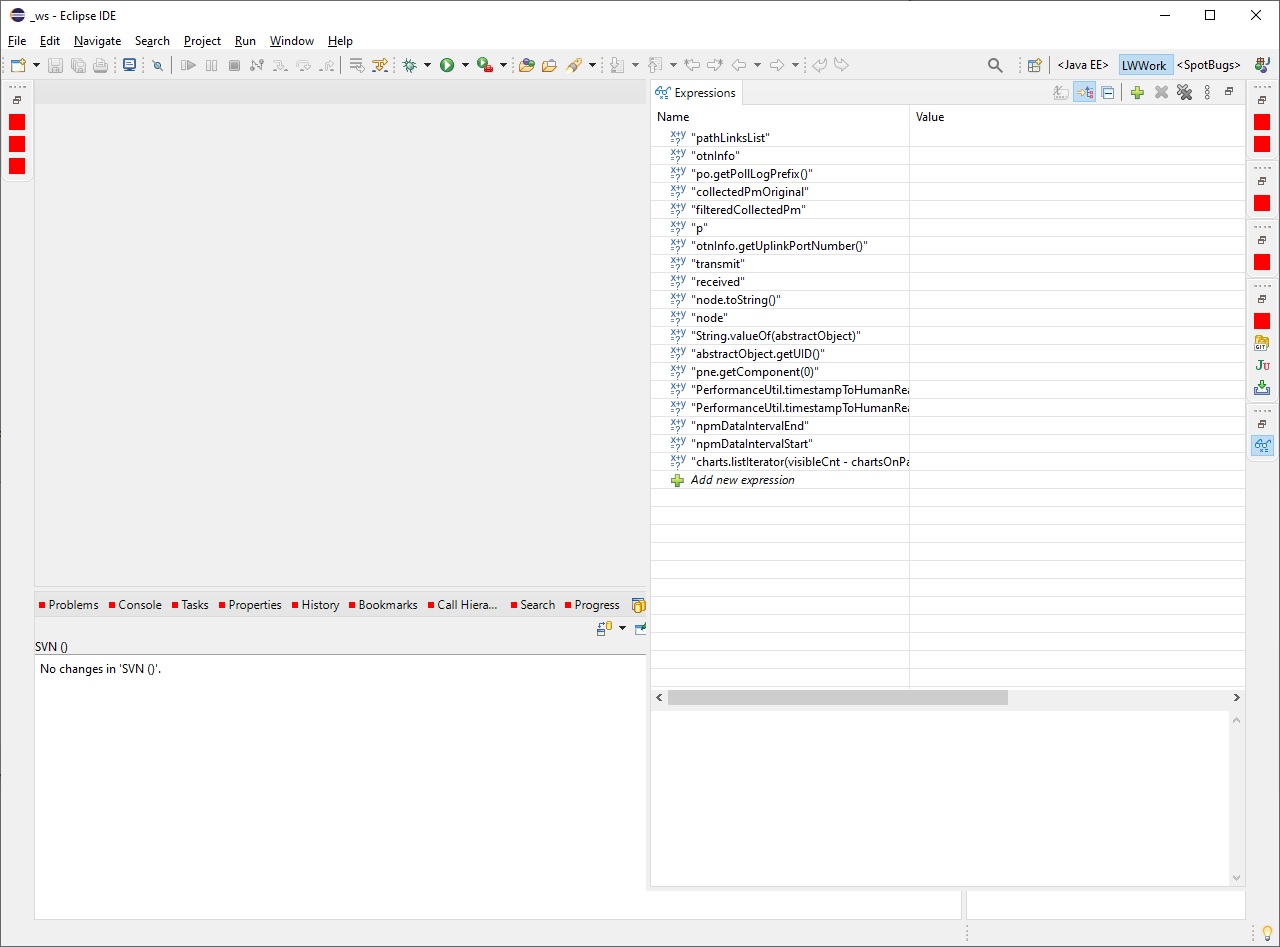

After updating to Eclipse 2020.12 most icons from Views are turned to red squares every time I restart Eclipse (screen 1). They turned back to normal when clicking on them (screen 2) until next restart. Any way to fix it?

I know that it looks like so but it is not the case I've shown on the screenshots the behavior: view icon appears when view clicked and that works for all views with red icons but all icons turns red again after eclipse restart. And this bug affects built-in views as well (for example Breakpoints, Variables, Expressions etc. views are affected). I've made a screen collage to show the problem on one image.
