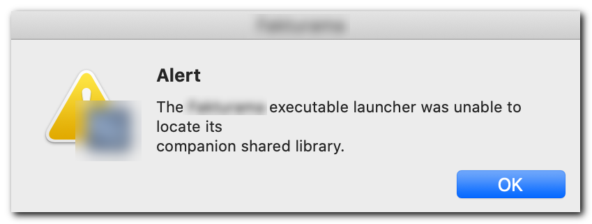

I've built an application with Maven Tycho. It'a a pure E4 application. If I launch it from target directory (or product folder, to be more precise), it runs successfully. Now, if I codesign that application (in the same folder), the application gets broken. If I try to launch it I get this error:
dlopen(/Users/myself/git/myproject/com.myproject.myapp.site/target/products/MyApp.ID/macosx/cocoa/x86_64/MyApp.app/Contents/MacOS//../Eclipse/plugins/org.eclipse.equinox.launcher.cocoa.macosx.x86_64_1.1.1300.v20200819-0940/eclipse_11103.so, 2): no suitable image found.  Did find:
	/Users/myself/git/myproject/com.myproject.myapp.site/target/products/MyApp.ID/macosx/cocoa/x86_64/MyApp.app/Contents/MacOS//../Eclipse/plugins/org.eclipse.equinox.launcher.cocoa.macosx.x86_64_1.1.1300.v20200819-0940/eclipse_11103.so: code signature in (/Users/myself/git/myproject/com.myproject.myapp.site/target/products/MyApp.ID/macosx/cocoa/x86_64/MyApp.app/Contents/MacOS//../Eclipse/plugins/org.eclipse.equinox.launcher.cocoa.macosx.x86_64_1.1.1300.v20200819-0940/eclipse_11103.so) not valid for use in process using Library Validation: mapping process and mapped file (non-platform) have different Team IDs
I've added also a screenshot of the error message. How could I codesign the application so that it works after codesigning?

I think that you define customization of the executable (the eclipse launcher), for instance with a custom icon. This changes the executable. As a result, you have to ensure that your Mac application is notarized correctly.
I don't have any experience with notarization of the application, so I cannot give you more clues. You might better answers by asking this on the tycho mailing list https://accounts.eclipse.org/mailing-list/tycho-user.

I've solved it by adding an entitlements file.
