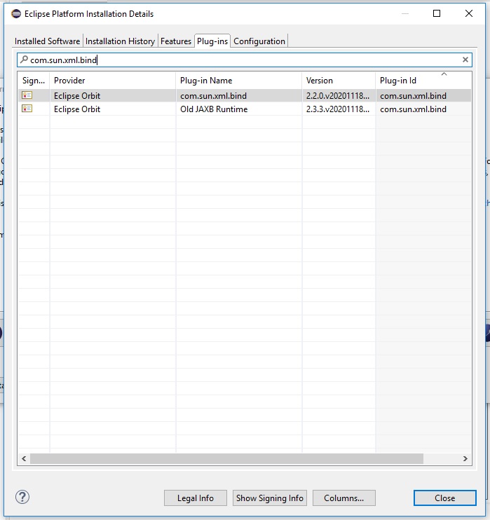

Re: Updated to Eclipse 2020-12 Unable to resolve mylyn bundle [message #1836073 is a reply to message #1836072] Sat, 19 December 2020 12:48 Go to previous messageGo to next message
I configured the version 2.2.0 not as greedy in my Oomph setup first, which was wrong. If you have both versions (2.2.0 and 2.3.3) listed as installed plugins then it should be fine.

I told you what I did. I use my own product catalog with Oomph and there I used the Eclipse Orbit to pull in the other version. Please tell me/us how you updated your Eclipse and if you have the 2 different versions listed as installed like in my screenshot.
