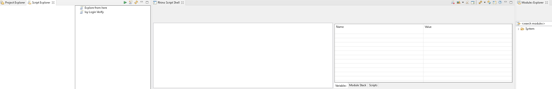

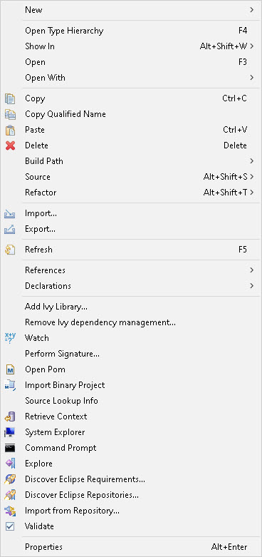

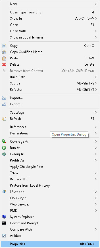

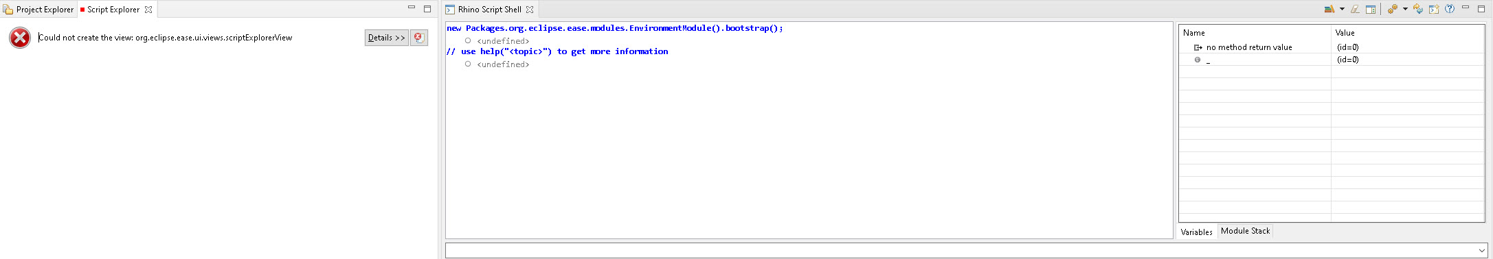

I've installed EASE from the Marketplace into Eclipse 2020-12 and it seems once it is there it takes over the context menus in my default perspective. The Scripting perspective also has a broken shell. If I remove just the UI Components feature it fixes my context menus and the shell but then I can't use the UI features. I'm not sure if this is a 2020-12 issue or another conflict.

Wrong Context menu:
index.php/fa/39510/0/
Correct Context menu (Team/etc):
index.php/fa/39512/0/
Broken Shell (with UI feature installed):
index.php/fa/39511/0/
Working Shell but broken script explorer (UI feature removed):
index.php/fa/39513/0/
