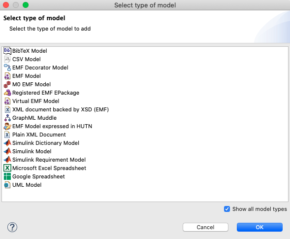

I am trying to get around Epsilon ETL and XText. I want to use the XText model to write some transformation rules, but I cannot add it to ETL. ETL, only accepts the following model types.
index.php/fa/39420/0/
Is there a way, to automatically generate one of these model types from the XText model? Or any other solution that might come to mind?
