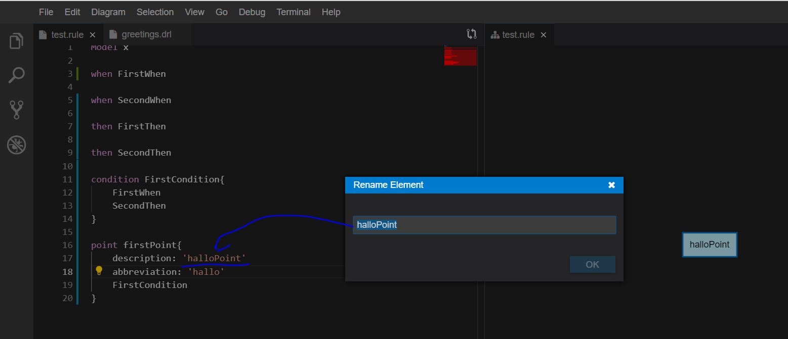

I created a simple dsl, and connected it with theia and Sprotty Server.(sprotty in Theia) What I did not understand is, trace of Attribute.
Change from text to graphic works good, but if I change text of a label (which is a STRING in DSL) it doesn't affect to text.
sprotty version is 0.8.0

Can somebody help to me please ? what am I doing wrong ?

Re: Sprotty from Graphical Change to Text [message #1832543 is a reply to message #1832337] Mon, 21 September 2020 06:17 Go to previous message
Miro Spönemann is currently offline Miro SpönemannFriend
Messages: 76
Registered: March 2015
Location: Kiel, Germany
Member
That's hard to say, you should investigate with a debugger. The build listener added by DiagramUpdater should be triggered by the text change:
https://github.com/eclipse/sprotty-server/blob/5d6c6c25e7d5d7ded5c19fc6282a1a45137154ac/org.eclipse.sprotty.xtext/src/main/java/org/eclipse/sprotty/xtext/ls/DiagramUpdater.xtend#L59-L61
You should check what happens there after you edit a label.
