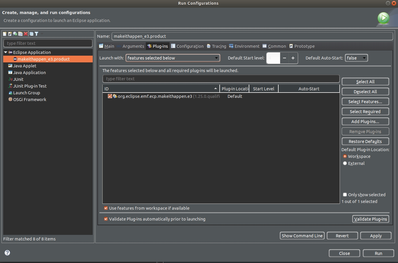

I installed the latest Eclipse (2020-09) via the Oomph tooling.
Everything works as expected.
The only problem is that I don't see any features from the default target in the run config.
See the attached screenshot.

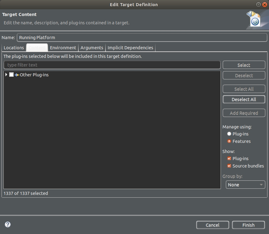

Ok I see that it is confusing what I wrote, sorry.
So I installed an Eclipse Modeling Tools via Oomph.
Then I tried to create a run config based on features, but none are offered, as shown in the screenshot.
So I did not set an explicit target and used the 'default' one eclipse sets.
Re: Features from platform target missing [message #1831876 is a reply to message #1831867] Tue, 01 September 2020 12:44 Go to previous messageGo to next message

As I wrote, I didn't set an explicit target platform. The one used by default is the 'Running Platform'.
This target should have all the features of the running eclipse instance, but in the case of installing the latest Modeling Tools via Oomph this target does not contain any features.
At least they are not accessible in any view one usually can access them.
Why I think this is related to Oomph is, that if I install Eclipse Modeling Tools 2020-09 M3 via Oomph I don't have any features available using the 'Running Platform', on the other hand all features are available if I download the Modeling Tools package directly.

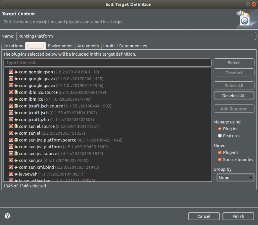

Re: Features from platform target missing [message #1831883 is a reply to message #1831878] Tue, 01 September 2020 14:14 Go to previous messageGo to next message
That is the problem, I don't see any features at all.
The plugins are all there though.
See attached screenshots.
