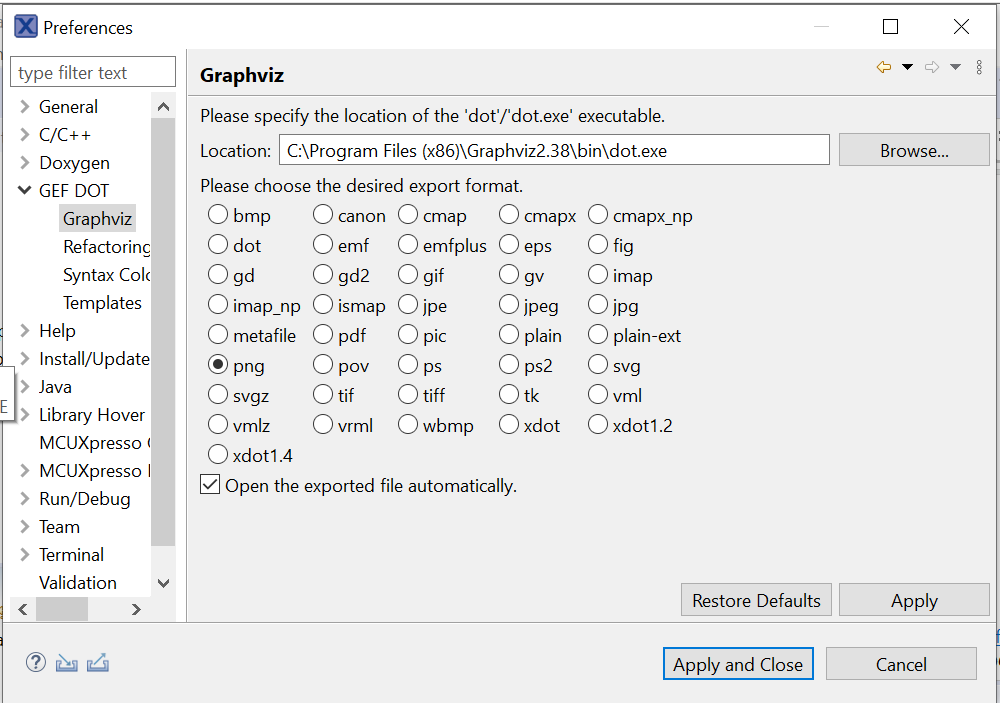

- option for output file type does not show file types (see image).

Hello Dave,
It is possible that GEF DOT is not yet compatible with Graphviz 2.44.1
I have just tested it with Graphviz 2.38 and it is fully working on my machine.
Could you please give it a try with Graphviz 2.38 and give feedback if it is working?

Version 2.38 shows file types.
index.php/fa/38836/0/

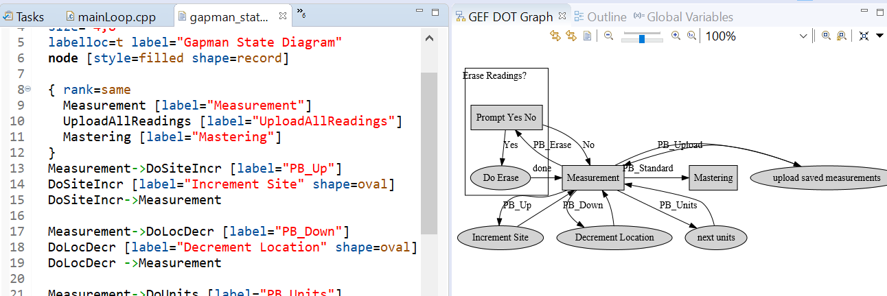

Even displayed the graph though unfortunately title is missing.
index.php/fa/38835/0/
Best Regards, Dave

Hello Dave,
Thanks for your feedback!
Based on the attached screenshot, the GEF DOT Plugin with Graphviz 2.38 is working as currently designed.
