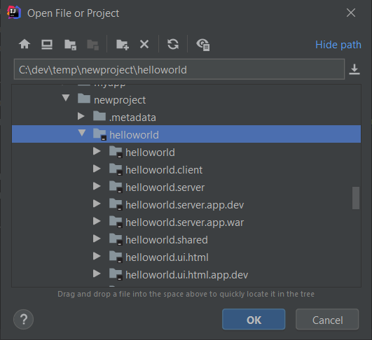

3. Select File, Open.
4. Select the root folder of the generated project (helloworld).

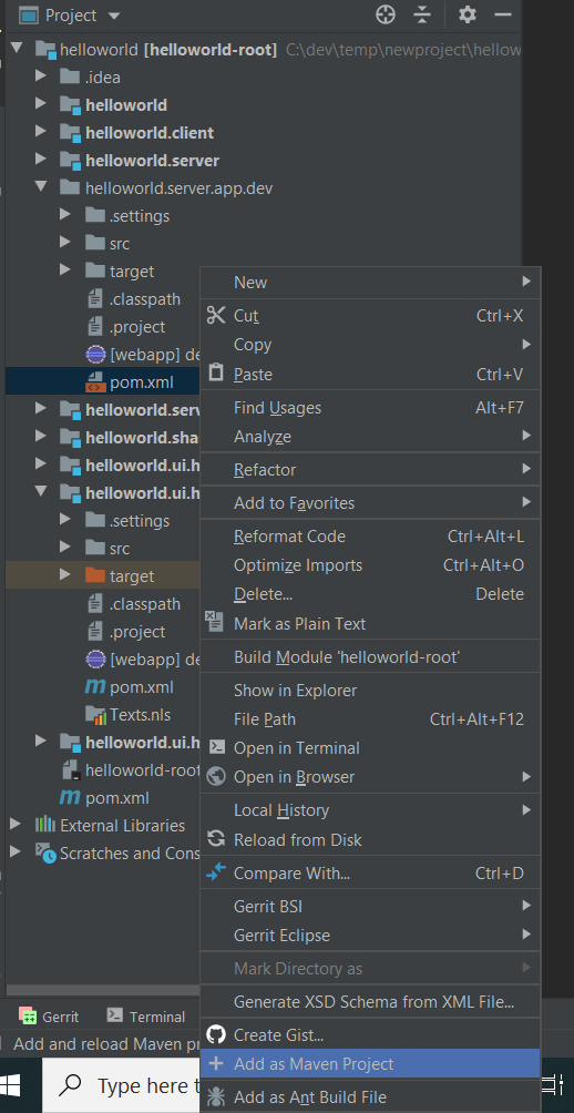

5. Ensure all modules are correctly added as maven projects. The name of the text needs to be bold, if the color is lighter (which probably is the case for helloworld.server.app.dev and helloworld.ui.html.app.dev), execute right click, Add as Maven Project
index.php/fa/38735/0/

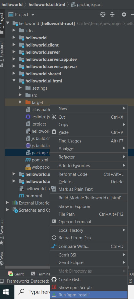

6. Run npm install on the package.json in helloworld.ui.html. You can do this on command line or right click, npm install.

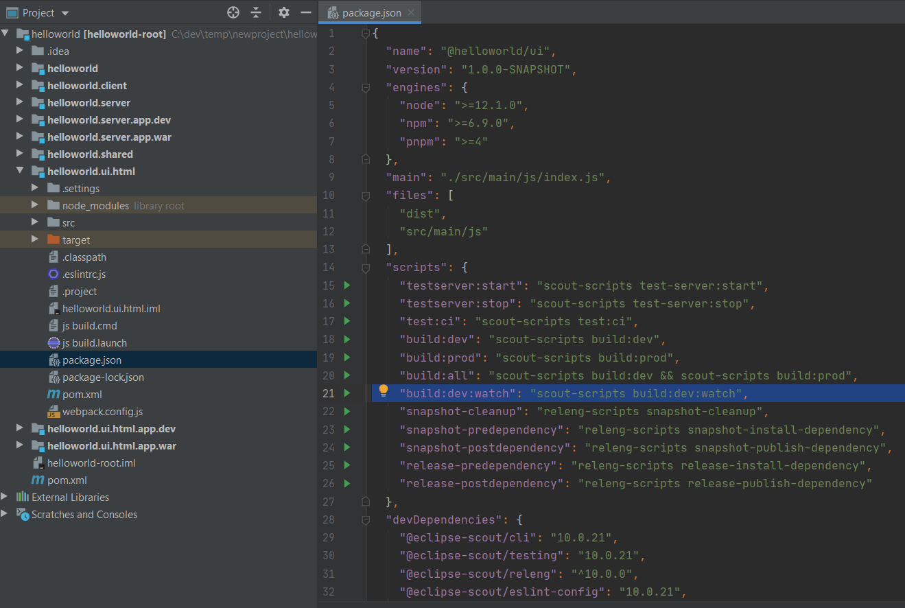

7. Start the watcher to build the JavaScript sources. You can do this on command line or open the package.json and click on the play icon on line 21.
index.php/fa/38737/0/

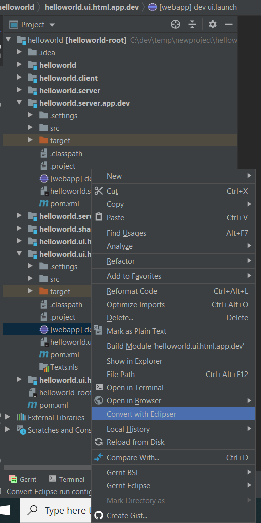

8. Convert the eclipse launch files into IntelliJ Run Configurations. You can do this easily with the IntelliJ plugin called Eclipser. Just install it using File, Settings, Plugins first. And then right click on the launch files and run "Convert with Eclipser". Do this for [webapp] dev ui.launch and [webapp] dev server.launch

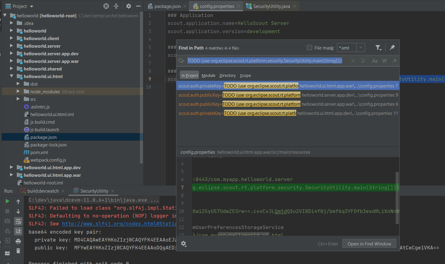

Additionally you need to create a public/private key pair and insert them into your config.properties, otherwise the app won't start.

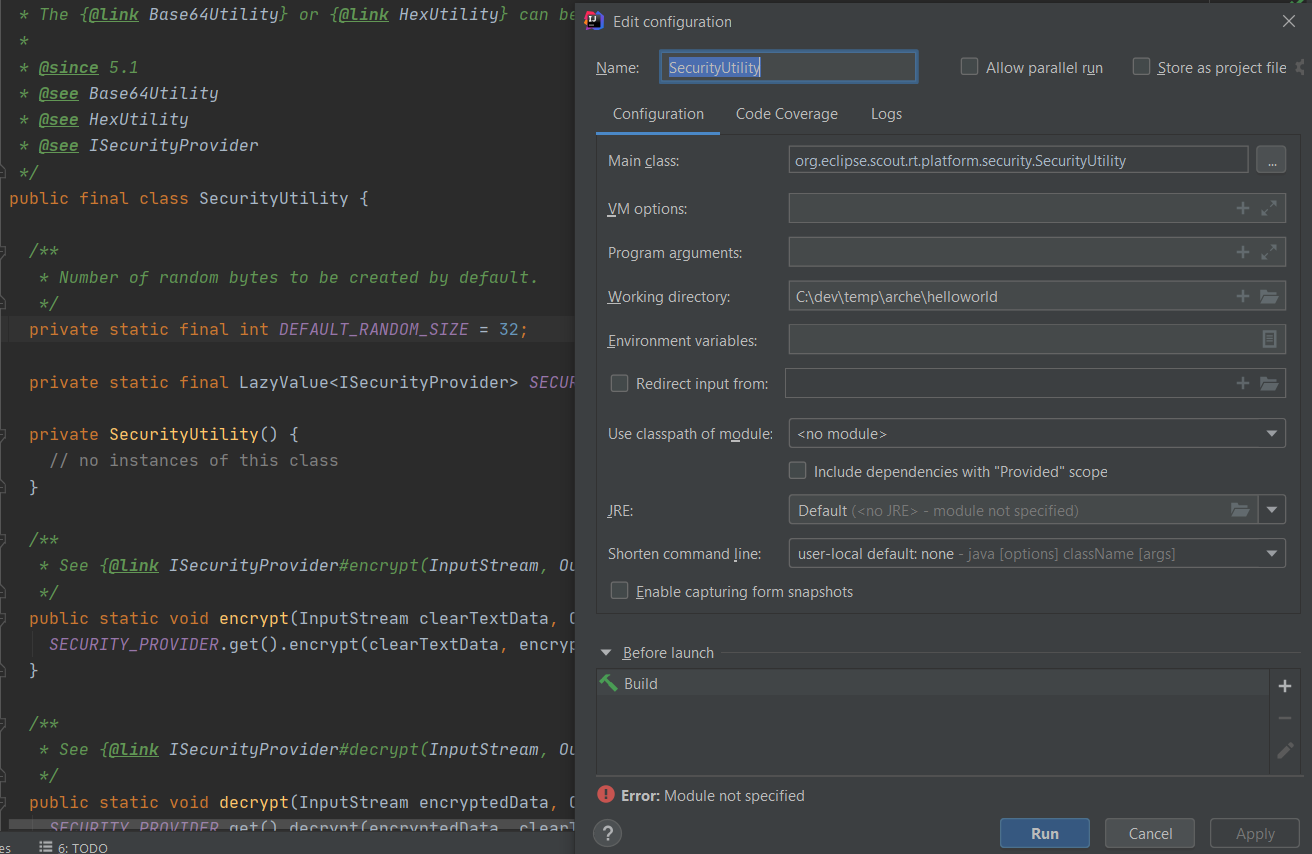

Therefore, open the class SecurityUtility (Ctrl+N) and run its main method (right click, Run SecurityUtility.main). Set the module helloworld.server in the field "Use classpath of module" and click ok.
index.php/fa/38739/0/
Now replace the TODO markers in the config.properties with the generated private and public keys.

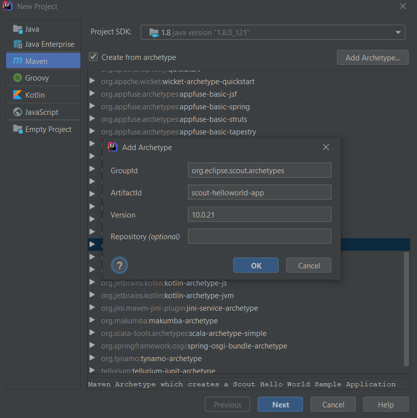

3. Click create from archetype and then "Add Archetype"
4. Fill the fields in the following way:

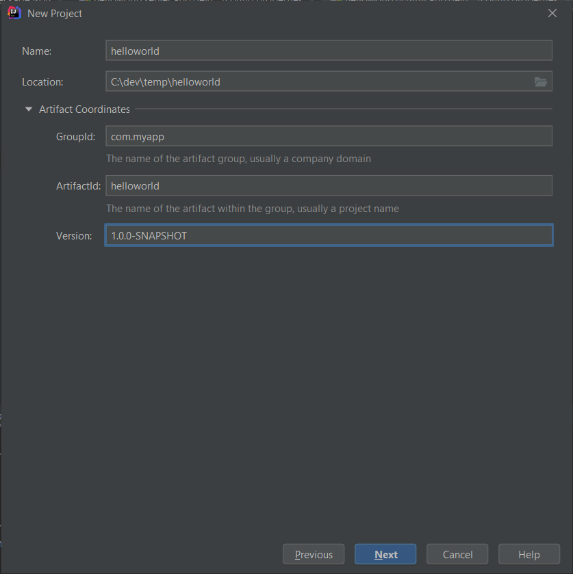

5. Click next and insert the properties for your project. Make sure to use a version with 3 digits or change the version in the package.json afterwards. 1.0-SNAPSHOT is not a valid version for npm, you need 3 digits. You could use 1.0-SNAPSHOT for the maven projects (pom.xml) and 1.0.0-snapshot for the npm project (package.json).

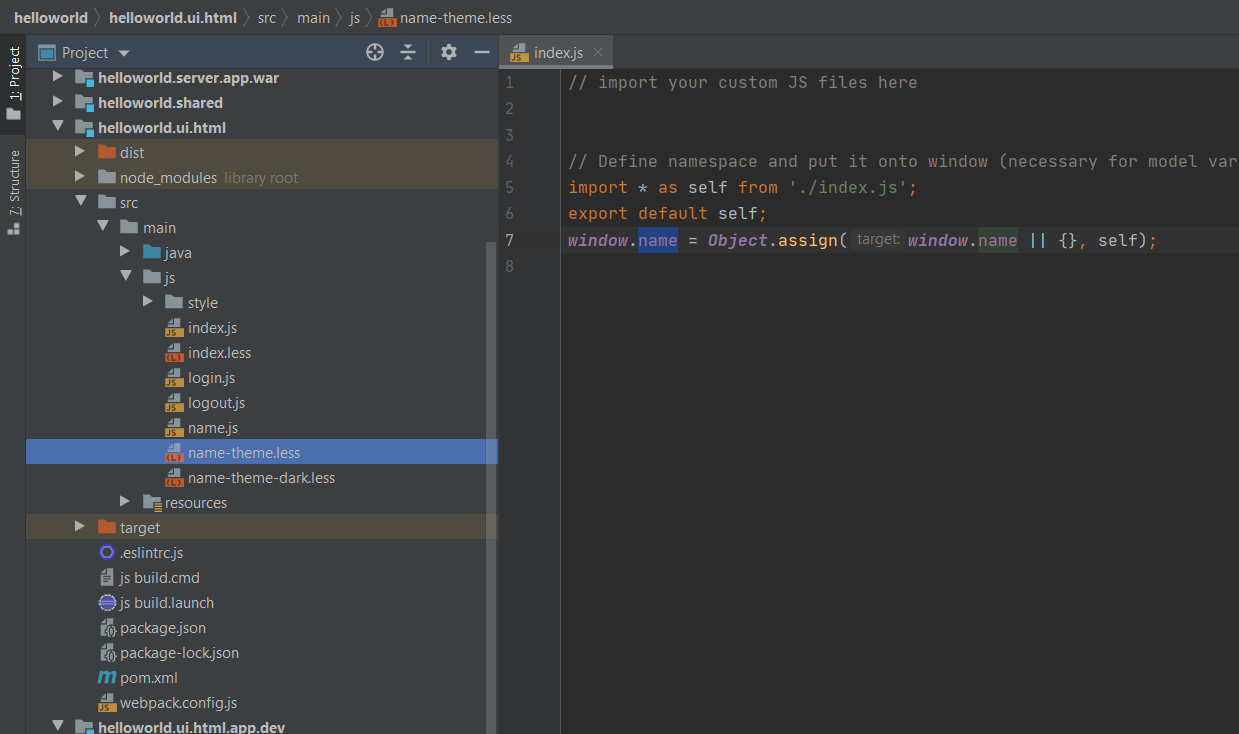

6. Change the names of the JS and Less files and rename the namespace (name.js, name-theme.less etc.)
index.php/fa/38743/0/
