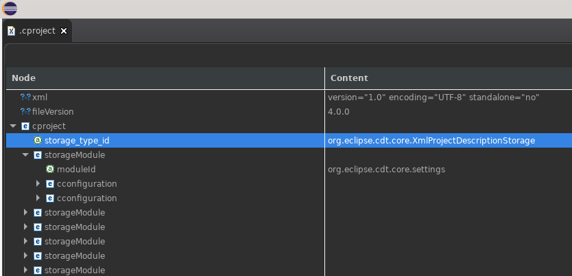

You can view it with the Eclipse XML editor.
That editor shows the content as a tree.
Here's a sample.
index.php/fa/38680/0/

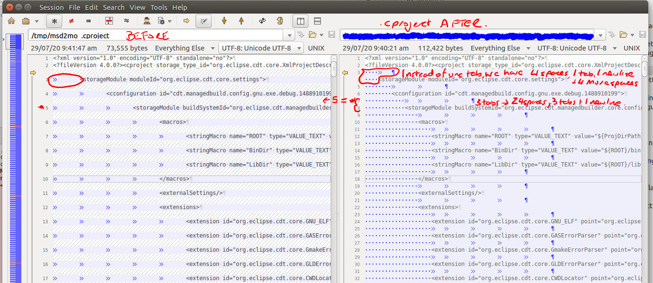

Here you go, see the attached image. That shows the before and after of a .cproject file. As you can see,:
1) the 1 tab in the cproject on the left has been replaced by 4 spaces, followed by 1 tab, followed by 1 newline, followed by 4 more spaces.
2) 2 tabs on the left becomes 8 spaces, followed by 2 tabs, followed by 1 newline, followed by 8 more spaces
3) 3 tabs on the left becomes 12 spaces, followed by 3 tabs, followed by 1 newline, followed by 12 more spaces
and so on.
If you know why this is, or whether there's a way to avoid this mangling, feel free to reply.
With all due respect, please don't reply if you're only going to ask why I care; that is irrelevant and doesn't add to the discussion.
