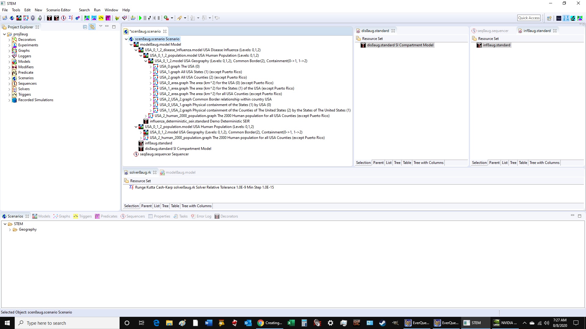

I just started fresh, and I am getting the same result. Here's the screenshot of the project, with everything (I hope) expanded properly.

Re: STEM error: missing a sequencer [message #1831085 is a reply to message #1830996] Tue, 11 August 2020 08:22 Go to previous messageGo to next message
I am not sure what the problem is but the link above does not seem to be working properly. There was no issue with linking to One Drive in the other post. Here's the screenshot.

Re: STEM error: missing a sequencer [message #1831389 is a reply to message #1831085] Tue, 18 August 2020 19:51 Go to previous messageGo to next message
Chris, your scenario is not composed correctly. I see two models for human population in the US and both your disease model and your infectors are in the wrong place.
Please see this doc.
https://wiki.eclipse.org/Creating_a_STEM_Scenario
