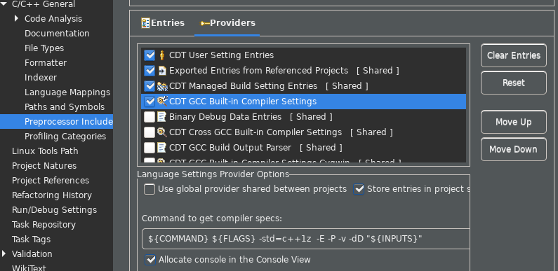

But if I try to set -std=c++1z flag in Eclipse IDE Settings this flag don't work.
C/C++ -> Build -> Settings -> GCC Built-in Compiller Settings
${COMMAND} ${FLAGS} -std=c++1z -E -P -v -dD "${INPUTS}"
I have 201402 not 201703
Please tell what I am doing wrong

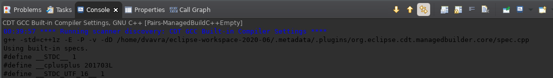

Re: Compiler flags [message #1829511 is a reply to message #1829492] Mon, 06 July 2020 00:37 Go to previous message
Set the Allocate Console in the Builtin Compiler Settings provider
index.php/fa/38503/0/
You should be able to see the command being executed
index.php/fa/38504/0/
Understand that this only affects the Indexer.
