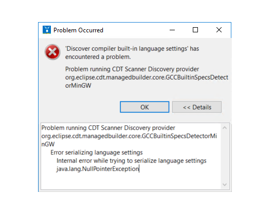

Our eclipse project have MinGW 4.9.2 originally. It works well. We plan to add MinGW 9..0 into our project. I modified the extension point "org.eclipse.cdt.managedbuilder.core.buildDefinitions", but it will cuase error.
The detailed extension project type is as follows:

Is there any error?
