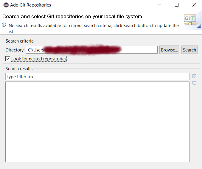

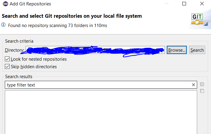

I have updated the git plugin and again the same issue persists.
When getting cloned from repo init ,
".repo" subdirectory is created and the .git folders for each clone is inside that.
Hence this .repo subdirectory is getting recognised but not the working directory of the clone where source code is present.
Here are the attachments,
1) When I search the working dir, where the source code is available.
2) When I search the .repo alone,

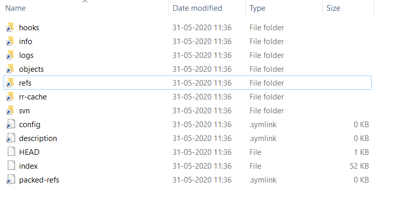

Here we can see the .git inside the " .repo direcotry" is getting recognized, but we need the .git inside the source code folder to be recognized.
Also I could see , the sub directories such as objects, refs, inside .git of source code folder are symlinks pointing to corresponding objects, refs of .repo
