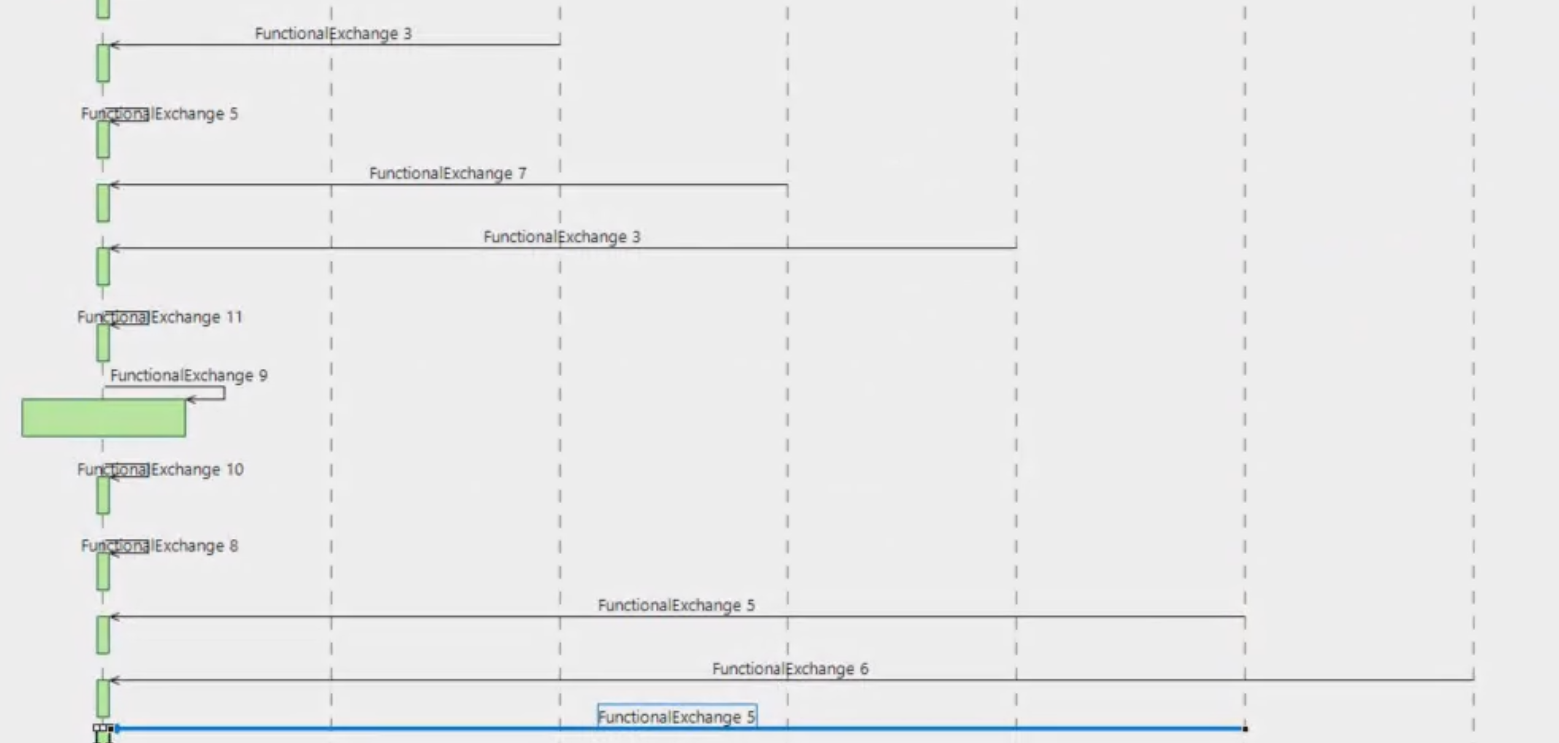

When I am transitioning a Functional Scenario to an Exchange Scenario, the displayed information does not show graphically the source and target function on each Component at either end of the functional exchanges ( see attached image).
Is there a way to trigger this? Manually adding the allocated functions on either end would be a bit intensive.

Hi Brandon,
I think there are two sides to your question:
- I believe it would be nice if functions are automatically initialized when doing the FS to ES automatic initialization, I don't really see a reason for not doing it but I may miss something, I am going to ask
- If it was done, or if you do it manually, this resulting diagram is not actually showing dependencies between your functions but rather the execution order, more information here: https://polarsys.org/forums/index.php/t/961/
