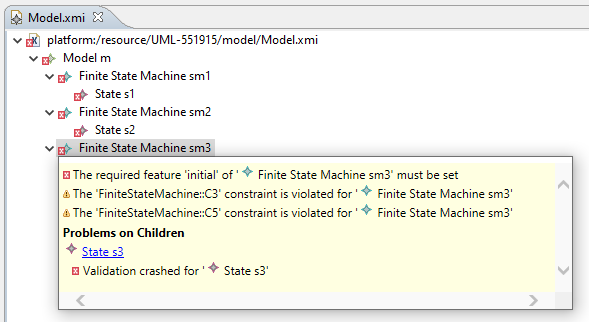

ValidationBug.zip is a zipped project that contains my reconstruction of the user's bad model and consequent OCL2Java auto-generation. (Load in Eclipse).
Model.xmi is an instance model. Load in nested Eclipse and Sample Ecore Model Editor.
BadLive.dbg is the live validation display. It shows no problems (because live validation crashed silently). Or if you have been evolving Model.xmi, it shows the stale problem markers from the last non-crashing LIve Valudation - very confusing.

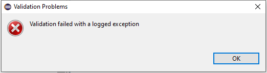

BadBulk.png shows the popup dialog diagnosing the crash of a bulk Validate.
index.php/fa/38112/0/

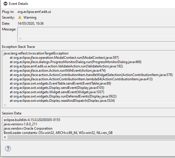

BadEvent.png shows the associated Error Log entry (with a blank message!)
index.php/fa/38113/0/

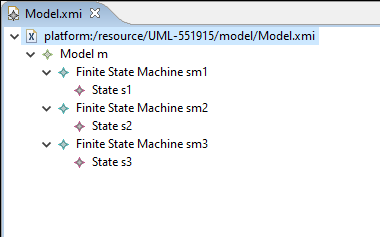

OkLive.png now shows many issues in the Live Validation.
index.php/fa/38115/0/

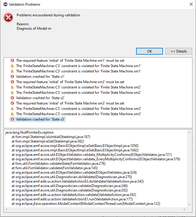

OkBulk.png now shows the issues and a stack trace in the traditional bulk Validate.
index.php/fa/38116/0/
The patch demonstrates that the Diagnostician is easily and very usefully converted from a tool that makes the unsound assumption that the model to be validated is well-formedly ill-formed to a validator that gives considerably more assistance in diagnosing really rubbish model/tooling.
(The try-catch in the patch is not where I expected; there may be a different validate call-chain that needs a similar try-catch.)
