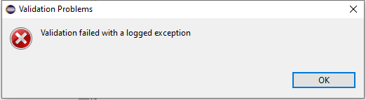

BadLive.dbg is the live validation display. It shows no problems (because live validation crashed silently). Or if you have been evolving Model.xmi, it shows the stale problem markers from the last non-crashing LIve Valudation - very confusing.
index.php/fa/38111/0/

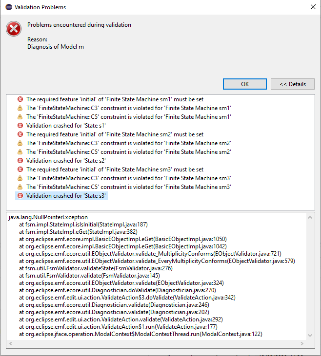

BadBulk.png shows the popup dialog diagnosing the crash of a bulk Validate.
index.php/fa/38112/0/

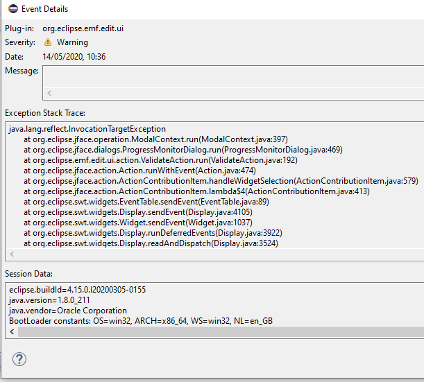

BadEvent.png shows the associated Error Log entry (with a blank message!)
index.php/fa/38113/0/

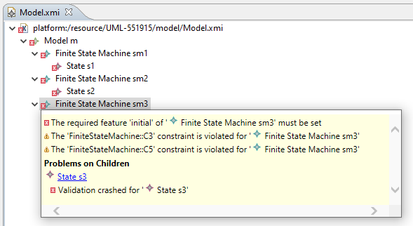

If we apply a patch to Diagnostician with a per-element try-catch...
OkLive.png now shows many issues in the Live Validation.
index.php/fa/38115/0/
OkBulk.png now shows the issues and a stack trace in the traditional bulk Validate.
index.php/fa/38116/0/
