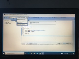

Every time I build a new project, I have to choose "New Launch Configuration" and set that up before the project will run. It took me forever to figure out how to do this!

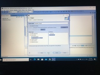

Thank you so much for responding, Nitin. I am sorry that I didn't see this response until now. The instructor's compiler looks a little different from mine, but he chooses File >New>C/C++ Project > Hello World C++ Project >
On his compiler, he then chooses Project >Build Project and that's it. Then he can run it.
On mine, I do this: File > New C/C++ Project. Then I get a window with a list of templates. I choose C++ Managed Build (A C++ Project build using the CDT's managed build system). This brings me to the same window as the instructors where I name the project and choose Hello World C++ Project (MinGW GCC is automatically selected). Then I can choose Build Project or just click the Hammer icon and this is where I get that extra step. I cannot just run - I have to use the New Launch Configuration dropdown menu and create a Launch Configuration. If I try to just run the project without this step, it will run one of the previously created launch configurations.
The instructor's compiler doesn't even have that Launch Configuration dropdown menu.
