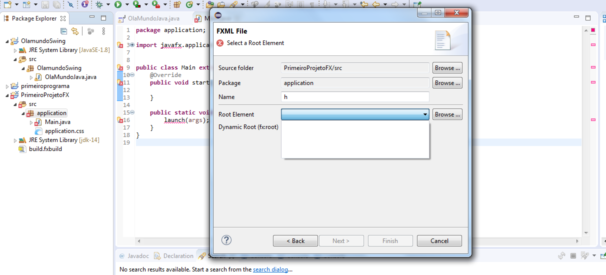

I have a question about "root elements".
I'm creating my first Java application through eclipse, but I'm not getting it.
There is no "element root" for me.
What I have to do? I installed something wrong, is there anything I have to fix? How do I do?
I appreciate if you can help!
Thanks in advance!

the picture shows, that the import javax... cannot be resolved. Note, that since Java 10, this is no longer part of the System library. You need to add it as a separate library to your project, perhaps after downloading, e.g., from https://openjfx.io/

I think that Daniel is using 1.8 .
odd.....
The picture shows two projects. The project where the problem occurs has a "jdk-14" System Library. Maybe that's by accident?

Now I see thanks.
