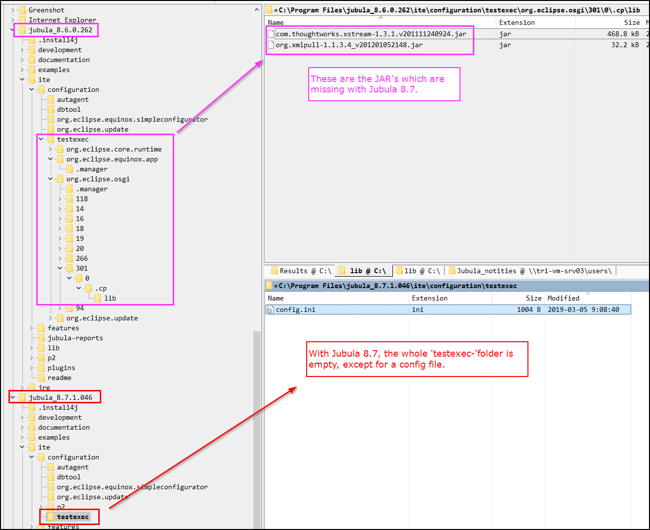

My Jubula 8.7 is missing these JAR's, see attachment.
I copied the JAR's, from 8.6 to 8.7 but Jubula 8.7 keeps complaining.
I noticed that Jubula workfolder already contains these JAR's, see attachment.
The JAR's are there, so why can't Jubula find them?

I fixed the 'No bundle found for ID' issues by putting:
osgi.framework.extensions=reference\:file\:org.xmlpull-1.1.3.4_v201201052148.jar,reference\:file\:com.thoughtworks.xstream-1.3.1.v201111240924.jar
into these ini files:
C:\Program Files\jubula_8.7.1.046\ite\configuration\config.ini
C:\Program Files\jubula_8.7.1.046\ite\configuration\testexec\config.ini
And I reduced the number of problems related to 'Timeout received before confirming the posted event'
by adding '-TEST_RC_IGNORE_TIMEOUT=true' as AUT argument.
Our test still don't run very well, but at least it has improved a little.
