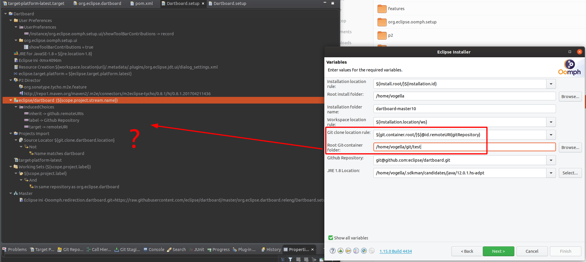

I would like to pre-select the Git clone location rule and Root Git-container folder in my Dartboard setup file.
index.php/fa/37120/0/
I guess that is as simple as knowing the right key for "InducedChoices" . But right-mouse click does not suggest any value.
I looked at https://help.eclipse.org/2019-12/index.jsp?topic=%2Forg.eclipse.oomph.setup.doc%2Fjavadoc%2Forg%2Feclipse%2Foomph%2Fsetup%2Fgit%2FGitCloneTask.html but didn't find a description for that.
Please advice.
Thanks, Lars

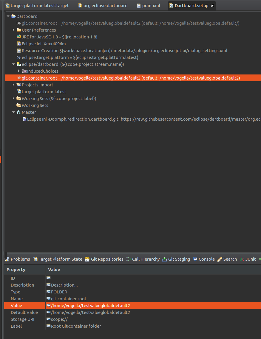

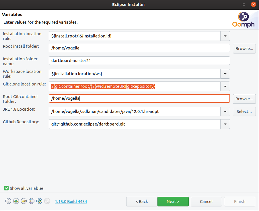

> In general look closely at your user.setup (Navigate -> Open Setup -> User) to see where and how such things are stored.
If I set the git.container.root this is currently ignore by the tooling. I tested this like this:
1.) Deleted Oomph configuration in the .eclipse folder via rm -rf org.eclipse.oomph.* to avoid previous choises to interfere
2.) Added git.container.root to both the global entry and the Git entry with the same content as I do not know if a global one will be picked up by the Git task, I guess yes but as it did not work, I tried adding it also to the Git one
index.php/fa/37132/0/
3.) Restarted the installer to get rid of any caching
4.) DnD the Dartboard.setup onto the installer
5.) Check the values on the installer screen after switching the Git clone location rule.
index.php/fa/37130/0/
Anything wrong with my testing?
Maybe Git clone location rule need to be set as well to consider git.container.root?

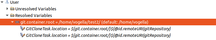

I see a node in "user.setup" containing an attribute node:
index.php/fa/37131/0/
<attributeRule
attributeURI="http://www.eclipse.org/oomph/setup/git/1.0#//GitCloneTask/location"
value="${git.container.root/}${@id.remoteURI|gitRepository}"/>
In the Oomph UI I do not see such an entry. Also the icon does not match anything I see. How can I set this?
[Updated on: Fri, 10 January 2020 05:37] by Moderator
Re: Predefining the Git clone location rule and Root Git-container folder [message #1819240 is a reply to message #1819234] Fri, 10 January 2020 06:37 Go to previous messageGo to next message
I see that Attribute Rules are only possible in the user.setup; it corresponds to org.eclipse.oomph.setup.User.getAttributeRules() so indeed only the user can configure/choose these.
The git.container.root ought to work, but I don't know where your testing failures might come from. Perhaps from having both a value and a default value on the variable? Perhaps from not using the project setup you think you are using? Perhaps because of the scope in which this variable is declared (it's induced from Git.ecore), it's simply not working to override it no matter what you do. In any case, it should not be necessary to override it because of course only the user knows what's a valid location on their machine and as requested the changes for https://bugs.eclipse.org/bugs/show_bug.cgi?id=559008 are already committed.
Re: Predefining the Git clone location rule and Root Git-container folder [message #1819242 is a reply to message #1819240] Fri, 10 January 2020 07:11 Go to previous message
