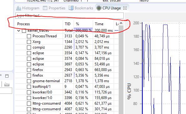

Anyway I would like to ask you an another question... Is there any option to setup default width of given tree viewer in CPU Usage view? (See attached image)
My every try failed. I was able to set default width in case I opened new instance of CPU Usage view manually but If the view has been opened by TC (restart of TC and so on) the width has been reset.
Re: CPU usage view [message #1818122 is a reply to message #1817949] Fri, 06 December 2019 04:48 Go to previous message
In the end I figured it out by myself. I overrided TmfChartView.performAlign(int offset, int width) method as blank one and my problem was solved.

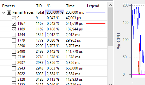

Would you please help me with another thing? I would like to implement new feature into TreeView part of CPU Usage. I want to have preselected specific items of tree. As it is shown (for example) in attached image. Any ideas, please?
