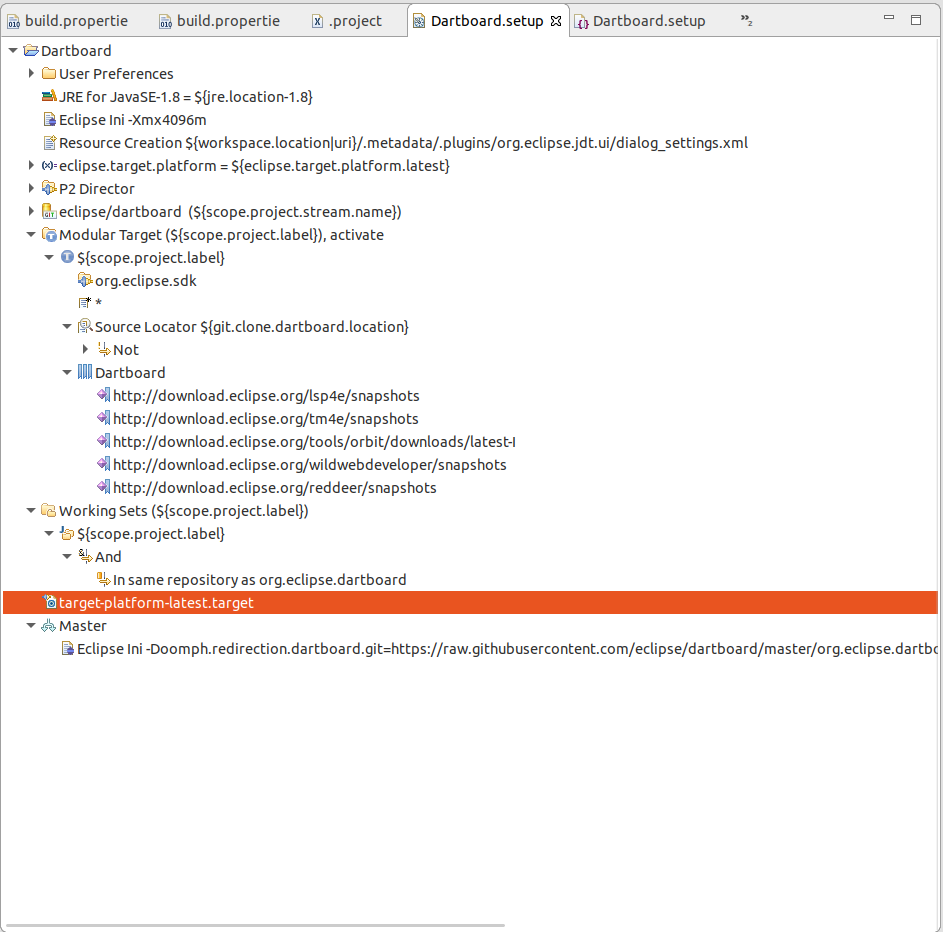

I would like to update https://raw.githubusercontent.com/eclipse/dartboard/master/org.eclipse.dartboard.releng/Dartboard.setup kindly provided by Ed to use the target definition file directly after the installation instead of using the "Modular Target" from Oomph.
What I did was adding a "Target Platform" entry below the Modular Target and used "target-platform-latest.target" (the name of the target) and get activate to true.
The activate flag seems to be the default, as it does not show up in the XML
<setupTask
xsi:type="pde:TargetPlatformTask"
id=""
name="target-platform-latest.target"/>
See screenshot.
If I run this updated project task, the target-platform-latest.target is not activated.
What do I do wrong?
Re: Using Oomph to activate a regular target platform (not a Target [message #1816154 is a reply to message #1816149] Tue, 22 October 2019 12:47 Go to previous messageGo to next message
The name attribute must specify the name of the target definition, not the full name of the .target file:
<setupTask
   id=""
   name="target-platform-latest"/>

Re: Using Oomph to activate a regular target platform (not a Target [message #1816163 is a reply to message #1816154] Tue, 22 October 2019 17:12 Go to previous messageGo to next message
Thanks Eike, but using the target file without extension did not do the trick.
<setupTask
I attached the setup file, in case you can have a look at it to see my error.

Re: Using Oomph to activate a regular target platform (not a Target [message #1816230 is a reply to message #1816163] Thu, 24 October 2019 09:49 Go to previous messageGo to next message
It seems you have no task to import the projects (in particular the one that contains the .target file) from the Git clone into the workspace. So PDE can't find the target definition. The Modular Target (Targlet) task would have done that for you. You can also use a task like this:
