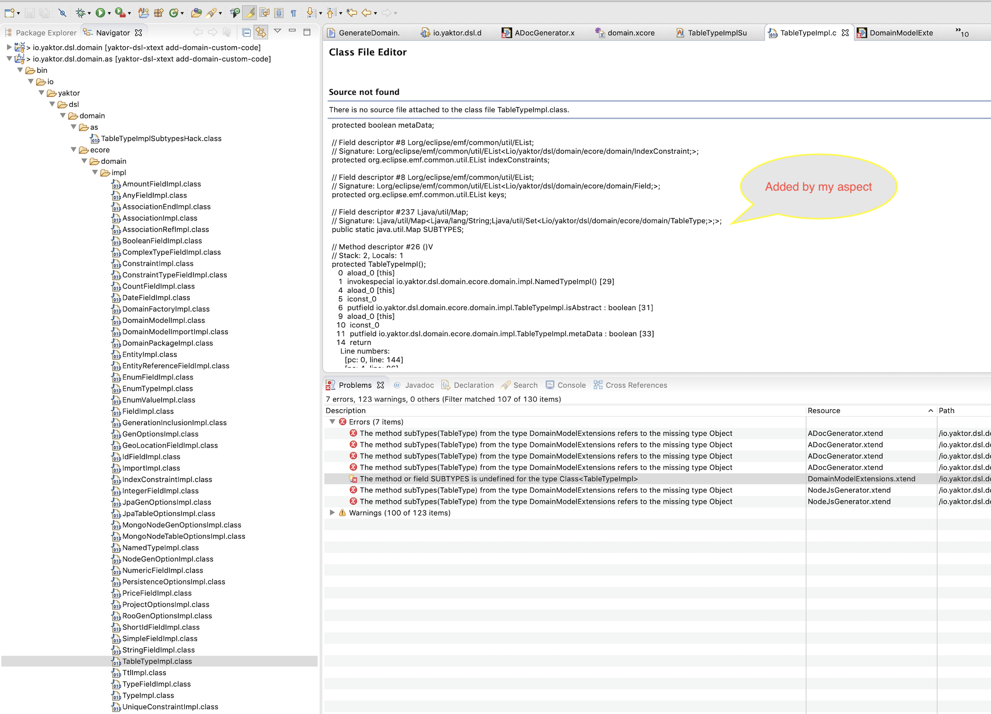

Been struggling with this for days.
I have an xcore project that's producing my EMF model & java files and I want to use _that_ project as the source of truth for the xtext project; reason is that I have some custom code added to the generated Java files (via aspectj, but that's really irrelevant). The model in that project is an .xcore file, and I'm getting my Java files generated & compiled perfectly.
How do I use _that_ bundle, and _only_ that bundle, in my core xtext project (the one that contains my .xtext & .mwe2 files), instead of referencing the .xcore file outside of the core xtext project?
Here's my .mwe2 file:

It looks like my .mwe2 file is still generating source somewhere and using that, or I'm not correctly referencing my emf project, even though my "Java Build Path" has a project reference to my EMF project.

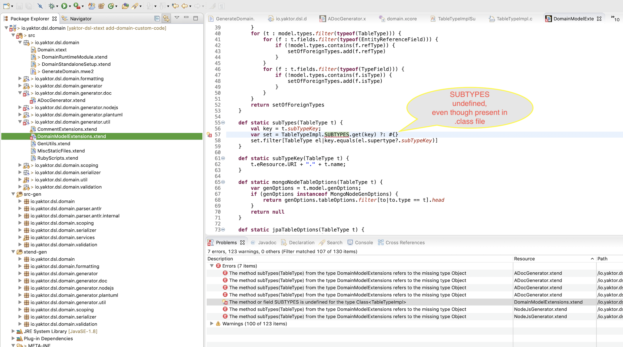

Since my xcore project is working fine, I think you're talking about the consuming project, which would be my core xtext project (the one containing my .xtext & .mwe2 file). If that's correct, I'm taking it that you mean to reference the xcore project's bundle in the META-INF/MANIFEST.MF of my core project, and remove the core project's reference to the xcore project. If not, please let me know. If so, then I've removed the project reference, and here's what I have for my MANIFEST.MF:

I get the following error when selecting my .xtext file, "Run As", "Generate Xtext Artifacts".

	at org.eclipse.xtext.xtext.generator.XtextGeneratorLanguage.initialize(XtextGeneratorLanguage.java:278)
	at org.eclipse.xtext.xtext.generator.StandardLanguage.initialize(StandardLanguage.java:189)
	at org.eclipse.xtext.xtext.generator.XtextGenerator.initialize(XtextGenerator.java:185)
	at org.eclipse.xtext.xtext.generator.XtextGenerator.checkConfigurationInternal(XtextGenerator.java:139)
	at org.eclipse.emf.mwe.core.lib.AbstractWorkflowComponent2.checkConfiguration(AbstractWorkflowComponent2.java:22)
	at org.eclipse.emf.mwe.core.lib.Mwe2Bridge.preInvoke(Mwe2Bridge.java:68)
	at org.eclipse.emf.mwe.core.lib.AbstractWorkflowComponent.preInvoke(AbstractWorkflowComponent.java:207)
	at org.eclipse.emf.mwe2.runtime.workflow.AbstractCompositeWorkflowComponent.preInvoke(AbstractCompositeWorkflowComponent.java:30)
	at org.eclipse.emf.mwe2.runtime.workflow.Workflow.run(Workflow.java:19)
	at org.eclipse.emf.mwe2.launch.runtime.Mwe2Runner.run(Mwe2Runner.java:102)
	... 4 more
The line that caught my eye is
XtextLinkingDiagnostic: null:3 Couldn't resolve reference to EPackage 'http://www.yaktor.io/dsl/domain'.
which makes sense, because nowhere in my xcore project or anywhere else now am I associating the the URI http://www.yaktor.io/dsl/domain to the model, AFAICT.
If I generate the .genmodel & .ecore files from the .xcore file (as detailed in https://wiki.eclipse.org/Xcore#Converting_an_Xcore_Model_to_a_GenModel), then point my .mwe2 workflow to the .genmodel via
		language = StandardLanguage {
			name = "io.yaktor.dsl.domain.Domain"
			fileExtensions = "ydm"
			emfGenerator = {
				skipGenerate = true
			referencedResource = "platform:/resource/io.yaktor.dsl.domain.as/model/domain.genmodel"
The "Generate Xtext Artifacts" command succeeds, but compilation fails because the compiler can't see the changes I made to the classes in the xcore project (see attached screenshots), which suggests to me that the core xtext project is not using the xcore project. I've decompiled the xcore project's .class files, and they all look correct, meaning they have the changes I've made to them.
I'm clearly either missing something. Any advice for this noob is appreciated! :)

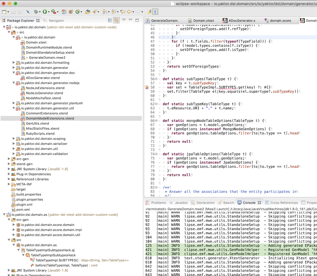

Thanks for the tip. I updated my Workflow to add a bean inspired by your citation. My .mwe2 now reads:
module io.yaktor.dsl.domain.GenerateDomain
import org.eclipse.xtext.xtext.generator.*
import org.eclipse.xtext.xtext.generator.model.project.*
import org.eclipse.emf.mwe.utils.*
var rootPath = ".."
Workflow {
	bean = StandaloneSetup {
		scanClassPath = true
		platformUri = ".."
		registerGeneratedEPackage = "io.yaktor.dsl.domain.ecore.domain.DomainPackage"
		registerGenModelFile = "platform:/resource/io.yaktor.dsl.domain.as/model/domain.genmodel"
	component = XtextGenerator {
		configuration = {
			project = StandardProjectConfig {
				baseName = "io.yaktor.dsl.domain"
				rootPath = rootPath
				runtime = {
					enabled = true
				runtimeTest = {
					enabled = true
				eclipsePlugin = {
					enabled = true
				eclipsePluginTest = {
					enabled = true
				web = {
					enabled = true
				createEclipseMetaData = true
				genericIde = {
					enabled = true
			code = {
				encoding = "UTF-8"
				lineDelimiter = "\n"
				fileHeader = "/*\n * generated by Xtext \${version}\n */"
			emfGenerator = {
				skipGenerate = true
When I "Generate Xtext Artifacts" now, I get successful generation, but the compilation errors persist:

My compilation errors are still present, however (see attached screenshot), with and without adding classes folder "io.yaktor.dsl.domain.as/bin" to the core project's "Java Build Path". Strangely, in my core project's source, when I "Open Declaration" (F3) on one of the types generated from my .xcore file, the IDE navigates me to the declaration in the .xcore file, not in the Java source, which confuses me.
Any advice?

The screenshot does not show anything

I beg to differ. It illustrates that eclipse can't find the symbols to which I'm referring.

It introduces a public static Map field to the EMF class TableTypeImpl, then intercepts any incoming call to TableTypeImpl#setSupertype(TableType), executes the code in the advice body (that is, within the "// UGLY" comments -- see full aspect advice in my prior post):
                // NOTE:  consider "thiz" below to be identical to "this"
		// UGLY logic for faking subTypes
		if (thiz.supertype != null && thiz.supertype.getModel() != null && thiz.supertype != newSupertype) {
			String key = thiz.supertype.getModel().getName() + "." + thiz.supertype.getName();
			TableTypeImpl.SUBTYPES.get(key).remove(thiz);
		if (newSupertype != null && newSupertype.getModel() != null) {
			String key = newSupertype.getModel().getName() + "." + newSupertype.getName();
			Set<TableType> tt = TableTypeImpl.SUBTYPES.containsKey(key) ? TableTypeImpl.SUBTYPES.get(key)
					: new HashSet<TableType>();
			tt.add(thiz);
			TableTypeImpl.SUBTYPES.put(key, tt);
		// END UGLY
then allows the call to setSupertype to proceed.
The static public Map introduced on TableTypeImpl is then used in our custom .xtend code in an extension method defined on class io/yaktor/dsl/domain/generator/util/DomainModelExtensions.xtend:
	def static subTypes(TableType t) {
		val key = t.subTypeKey;
		var set = TableTypeImpl.SUBTYPES.get(key) ?: #{}
		set.filter[TableType el|key.equals(el.supertype?.subTypeKey)]

public class TableTypeImplCustom extends TableTypeImpl {
	public static Map<String, Set<TableType>> SUBTYPES = new HashMap<String, Set<TableType>>();
	public void setSupertype(TableType newSupertype) {
		if (supertype != null && supertype.getModel() != null && supertype != newSupertype) {
			String key = supertype.getModel().getName() + "." + supertype.getName();
			SUBTYPES.get(key).remove(this);
			Set<TableType> tt = SUBTYPES.containsKey(key) ? SUBTYPES.get(key)
			tt.add(this);
		// END UGLY
		super.setSupertype(newSupertype);
This, of course, causes the factory impl class to use the custom class:
public class DomainFactoryImpl extends EFactoryImpl implements DomainFactory
	public TableType createTableType()
		TableTypeImplCustom tableType = new TableTypeImplCustom();
		return tableType;
You can think of the aspectj stuff as just a different means of customizing the generated EMF code in my Xcore project. I'm letting the Xcore project generate the Java files as normal, but I'm using aspectj to make my customizations at compile time. In the end, the customizations are behaviorally the same in both cases, with only slight variations in where the customizations are made.
