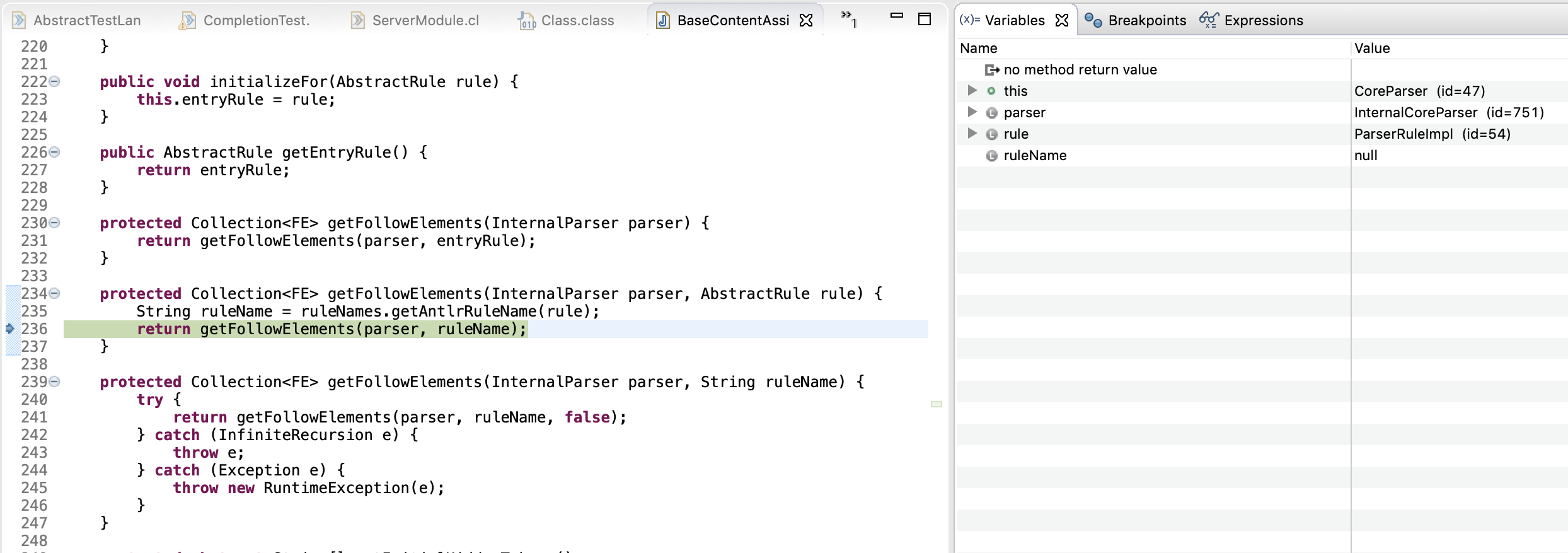

I'm new to Java, let alone Xtext, and all of this giving me a lot of pain.
I did manage to debug but for content assist the only way I figured out is to attach to Tomcat. Kind of annoying.
As for testing, I'm currently stuck on some generated stuff missing in my setup. Apparently the tests need an InjectorProvider like the example PartialContentAssistTestLanguageInjectorProvider
I really wouldn't like to copy/paste something similar into my repository. Any suggestions on what I need to to to get this generated in my .ide project?

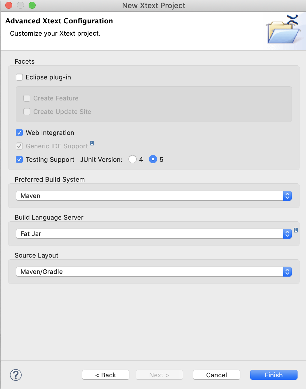

Re: No LSP suggestions when keywords are separate parser rules [message #1809598 is a reply to message #1809597] Thu, 18 July 2019 12:18 Go to previous messageGo to next message
I created setting up as shown on the attached image.
It generates test in dsl project but no tests in either web or ide
  • Attachment: maven.png
    (Size: 145.60KB, Downloaded 95 times)
Re: No LSP suggestions when keywords are separate parser rules [message #1809599 is a reply to message #1809598] Thu, 18 July 2019 12:20 Go to previous messageGo to next message
Please use source layout default / plain
(Not maven /Gradle)
Re: No LSP suggestions when keywords are separate parser rules [message #1809600 is a reply to message #1809599] Thu, 18 July 2019 12:24 Go to previous messageGo to next message
But it might be that you have to customize / manually create the injector provider anyway so that your use mifule and binding is used

and not a npe
Re: No LSP suggestions when keywords are separate parser rules [message #1809636 is a reply to message #1809635] Fri, 19 July 2019 03:33 Go to previous messageGo to next message
=> how does your proposal provider customization look like?
Re: No LSP suggestions when keywords are separate parser rules [message #1809637 is a reply to message #1809635] Fri, 19 July 2019 04:04 Go to previous messageGo to next message
Christian Dietrich wrote on Fri, 19 July 2019 07:31
ähmm no
when i change hydra to
ok, sorry. must have forgotten to run the workflow.
Not too fancy until I figure out how to work with the grammar model:
https://github.com/hypermedia-app/hypertest/blob/keyword-code-assist/app.hypermedia.testing.dsl.ide/src/main/java/app/hypermedia/testing/dsl/ide/editor/contentassist/CoreContentAssist.xtend
I experiment some more and indeed, a test for the sub grammar passes. Only the base grammar throws NPE.
Again, weirdly enough, code assists work fine for both languages in ace editor.
Re: No LSP suggestions when keywords are separate parser rules [message #1809639 is a reply to message #1809637] Fri, 19 July 2019 04:27 Go to previous messageGo to next message
yes the grammars beeing singleton does not work for subgrammars.
Re: No LSP suggestions when keywords are separate parser rules [message #1809640 is a reply to message #1809639] Fri, 19 July 2019 04:32 Go to previous message
inverting the order in *ide/src/main/xtext-gen/META-INF/services/org.eclipse.xtext.ISetup
seems to help as well
