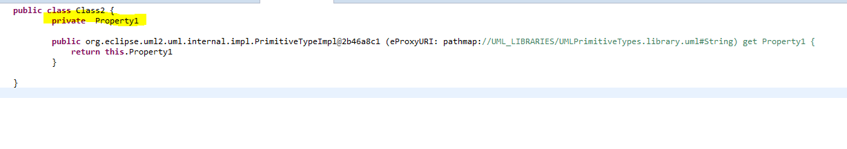

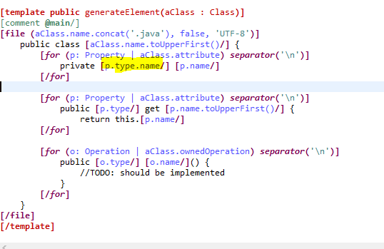

i have the generated given below
index.php/fa/35784/0/
In the result of the code the p.type.name is generating empty string. as given below
index.php/fa/35785/0/
can any when please guide me.

HI
You omit all the relevant parts of your repro but it looks like a FAQ.
Shortly after your empty string is a proxy URI that reveals that you are using UML and that like many others you have neglected to read the instructions in the generated Java that tell you how to initialize usage of the UML metamodel.
Ed Willink
