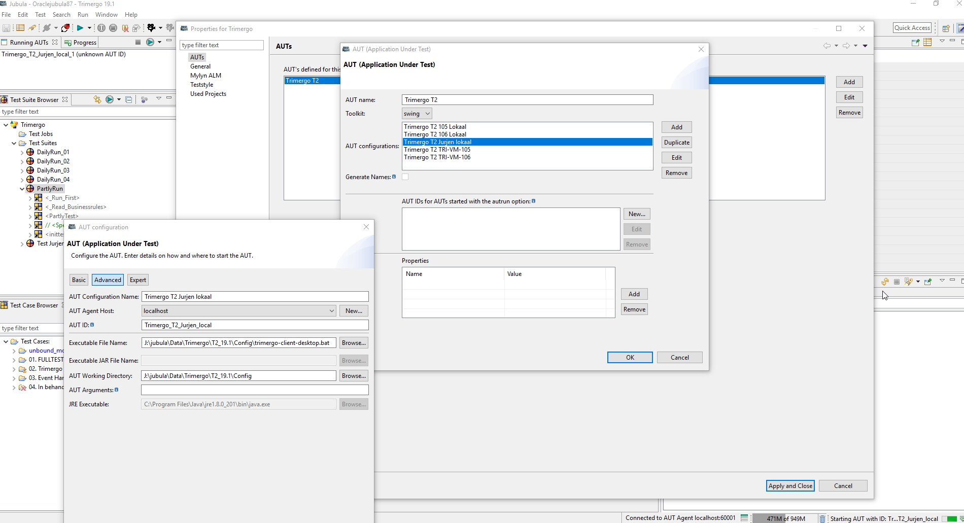

I'm trying it once again, but i don't succeed. So we are using Swing. If i'm using a .bat executable or .cmd doesnt matter. In both cases it doesnt work.
I also tried removing all AUT configurations and add one again to test, but the same result...
i also added the aut configuration (.png file) and the .bat file
i hope you can help me.
thanks in advance!
kind regards Jurjen

Re: Cannot start AUT with Jubula 8.7.1.046 [message #1810810 is a reply to message #1810599] Tue, 20 August 2019 02:31 Go to previous messageGo to next message
Can you please look into the export section of the Aut configuration if there is some wrong setup?
best regards
Marvin Mueller
Re: Cannot start AUT with Jubula 8.7.1.046 [message #1810826 is a reply to message #1810810] Tue, 20 August 2019 05:11 Go to previous messageGo to next message
Hello Marvin,
Jubula is putting an extra java argument in between:
If i start the aut without Jubula, visual vm shows as expected:
sun.java.command=com.trimergo.client.TrimergoClient http://localhost:7501/trimergo/gateway/client
and the aut will start.
But if i try to start the aut from Jubula, visual vm shows:
sun.java.command=com.trimergo.client.TrimergoClient C:\Program Files\jubula_8.7.1.046\ite http://localhost:7501/trimergo/gateway/client
Now i also get an error message that the AUT start failed:
5009: AUT start failed
Establishing connection to AUT failed.
Please check the AUT configuration. AUTServer could not start: Invalid arguments.;
SLF4J: Class path contains multiple SLF4J bindings.
SLF4J: Found binding in [jar:file:/J:/jubula/Data/Trimergo/T2_19.1/Software/trimergo-server-19.1-SNAPSHOT/webstart/libs/logback-classic-1.2.3.jar!/org/slf4j/impl/StaticLoggerBinder.class]
SLF4J: Found binding in [jar:file:/C:/Program%20Files/jubula_8.7.1.046/ite/plugins/ch.qos.logback.slf4j_1.0.7.v201505121915.jar!/org/slf4j/impl/StaticLoggerBinder.class]
SLF4J: See http://www.slf4j.org/codes.html#multiple_bindings for an explanation.
SLF4J: Actual binding is of type [ch.qos.logback.classic.util.ContextSelectorStaticBinder]
java.lang.IllegalStateException: Server argument should start with http.
at com.trimergo.client.TrimergoClient.argsCheck(TrimergoClient.java:103)
at com.trimergo.client.TrimergoClient.<init>(TrimergoClient.java:59)
at com.trimergo.client.TrimergoClient.main(TrimergoClient.java:42)
Picked up _JAVA_OPTIONS: "-javaagent:C:\Program Files\jubula_8.7.1.046\ite\plugins\org.eclipse.jubula.rc.common.agent_7.0.2.201902270829.jar"
I have now added a screenshot with also the expert section of the AUT configuration. But since these fields are empty, i think the problem lies somewhere else...
Thanks for your help so far
kind regards
Jurjen
