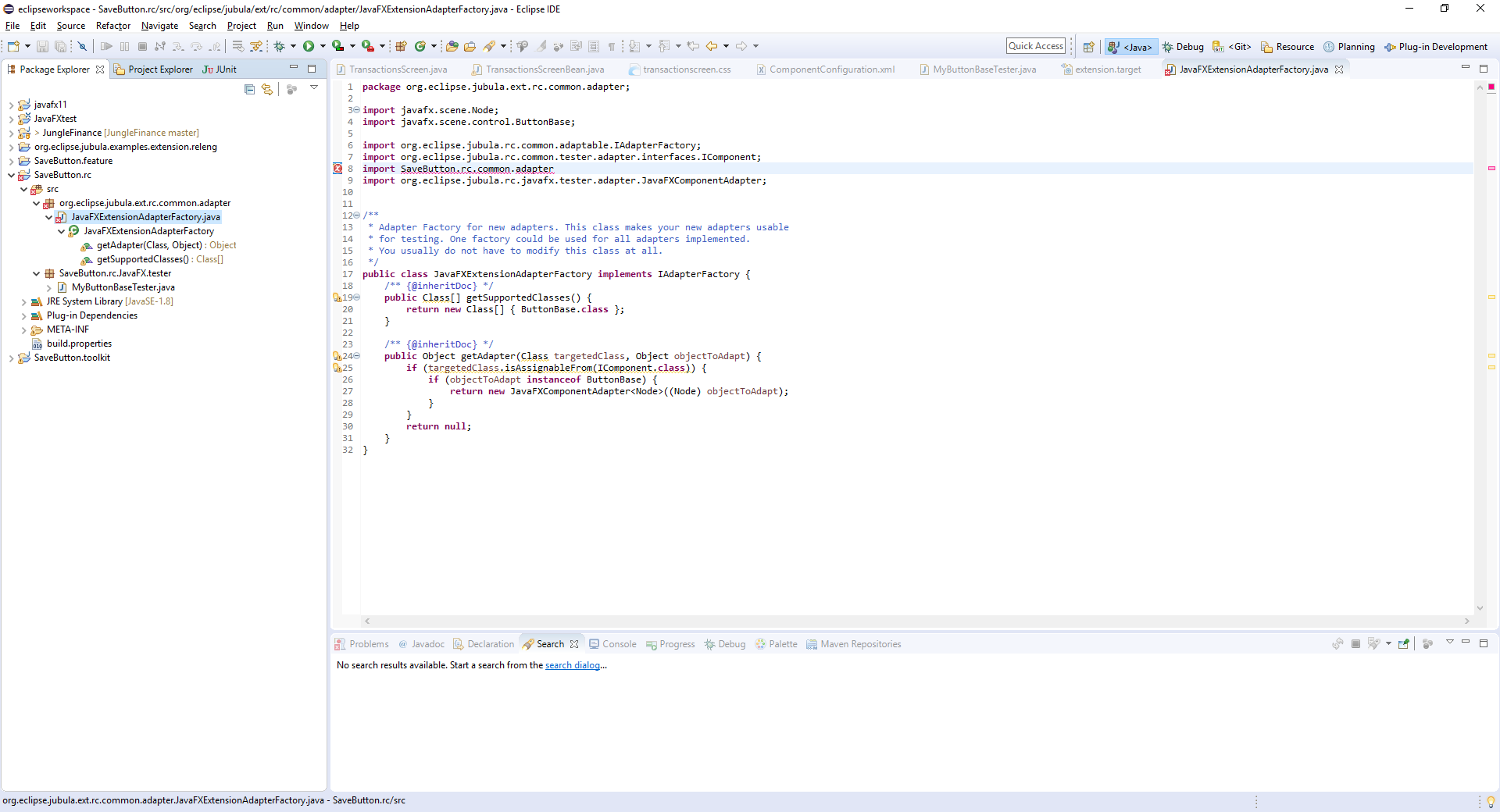

Extra Information:
When I run the Jubula Extension wizard the code generated does not compile.
See enclosed screen shot.
Re: Extending Jubula [message #1808149 is a reply to message #1807919] Tue, 18 June 2019 04:50 Go to previous messageGo to next message
I can reproduce the Problem. You are right with the Bug you mentioned. I think this is the issue. Since we plan to update the Jubula installer also to a newer eclipse rcp version it should be fixed with the next release. Thanks for your research!
