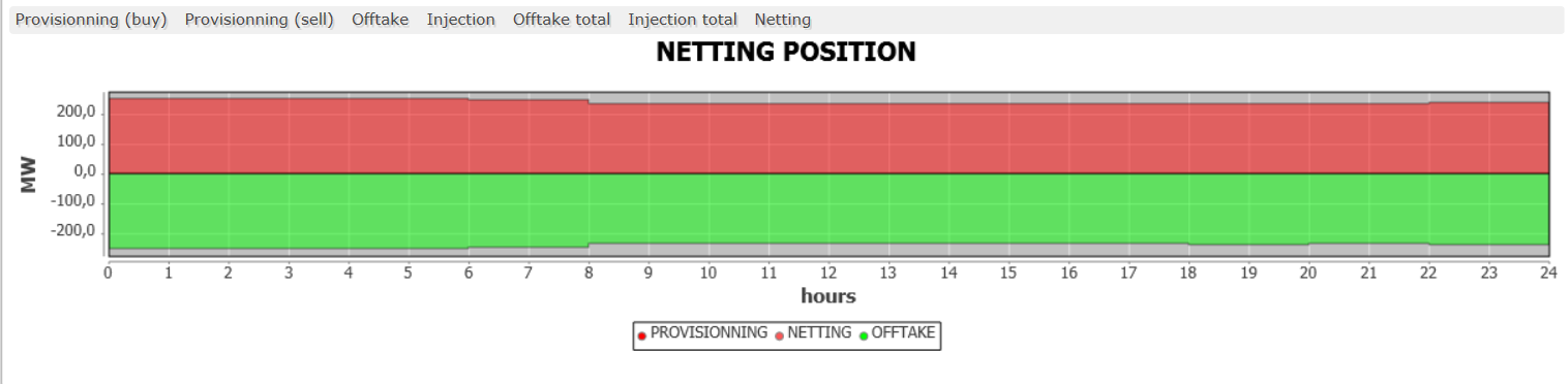

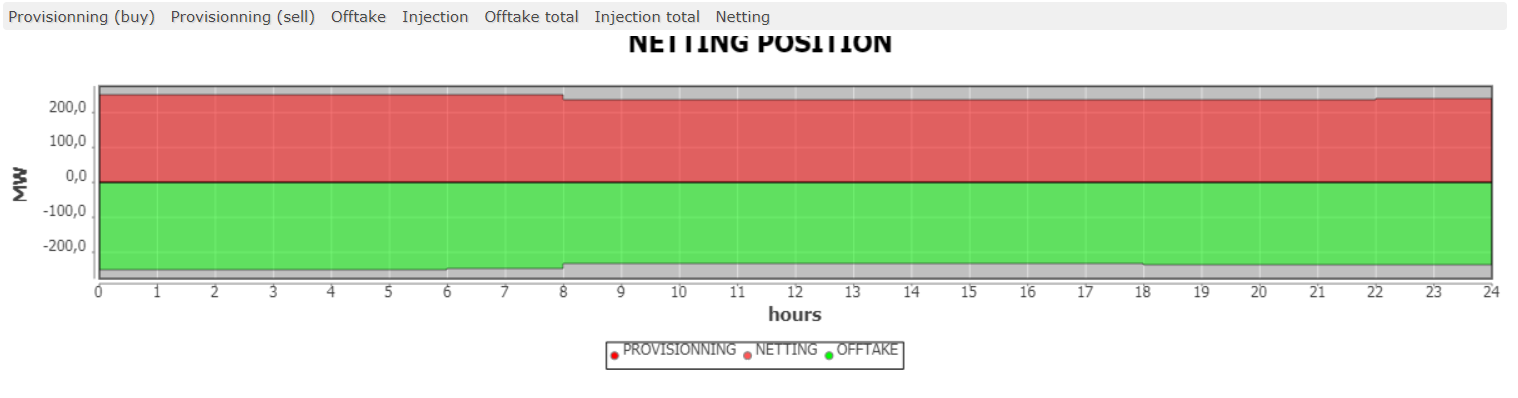

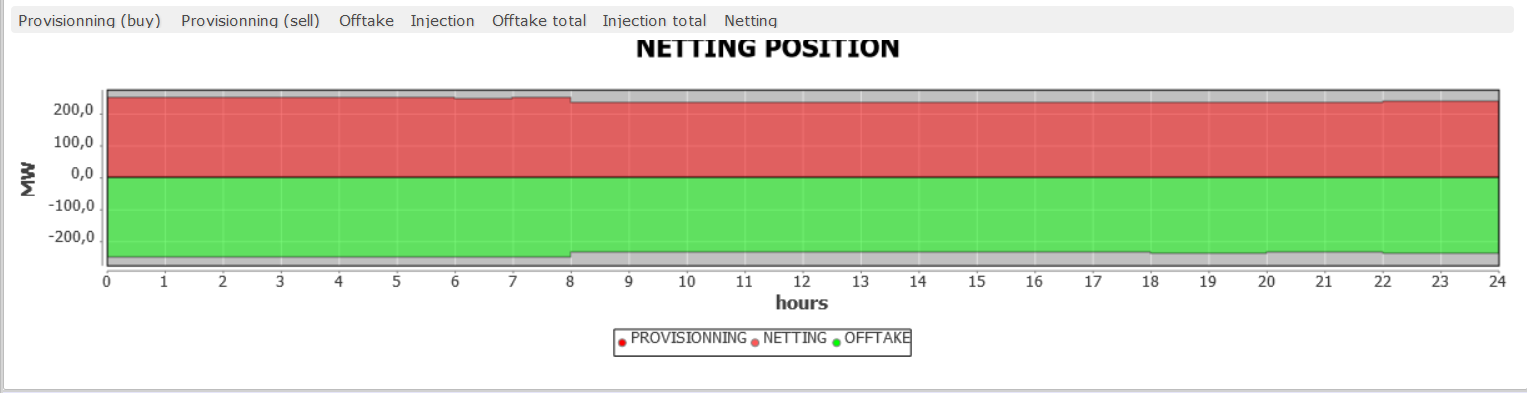

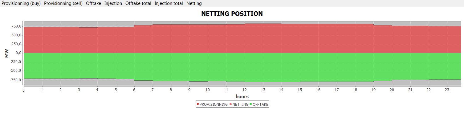

I migrate my RCP application to RAP.
My application uses a lot of JFreeChart graphs and I add some problems :
- Dotted lines are drawn as solid lines
- Graphs seem to be zoomed and owerflow the view (the picture seems blurry)
- Some fonts seem to be changed by anothers
I have attached capture screens for the second point.
  • Attachment: firefox.png
    (Size: 50.61KB, Downloaded 253 times)
  • Attachment: chrome.png
    (Size: 52.09KB, Downloaded 249 times)
  • Attachment: ie.png
    (Size: 50.75KB, Downloaded 244 times)
  • Attachment: rcp.png
    (Size: 28.68KB, Downloaded 216 times)

Thanks but setting this property does not work.
I don't generate image. I am able to interact with the chart (zoom, save, hide/unhide graph)
It is like if the destination canvas is larger than the canvas itself.
