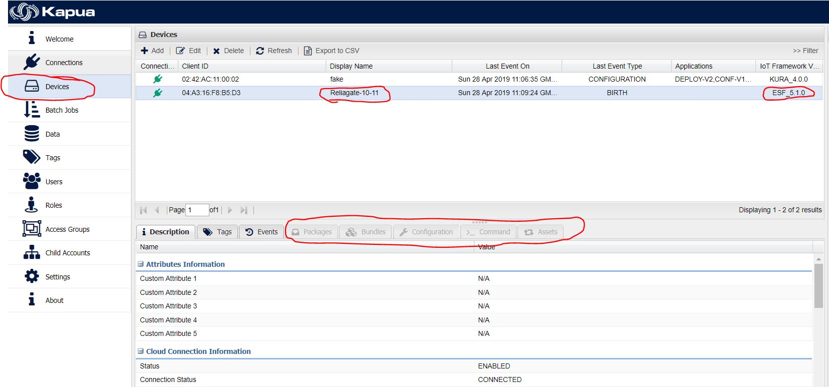

Hi there,
I can connect to Kapua my Eurotech ReliaGATE 10-11 gateway with ESF 5.1 (Eurotech's proprietary gateway management software, which is based on Kura), but the "Configuration" tab is greyed out.
I'm under the "Devices" menu, and I can only click on "Description", "Tags", and "Events". "Packages", "Bundles", "Configuration", ">_ Command", and "Assets" are all greyed out. Is this because ESF 5.1 is not fully compatible with Kapua?

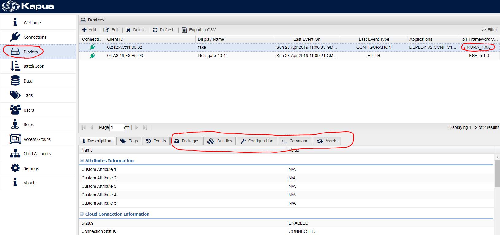

I also created a test Kura gateway in AWS, and it also connects to Kapua, and nothing is greyed out (i.e. everything is fully-functional).

from the screenshot you sent the ESF device is missing the "Applications", which are used to enable/disable tabs.
Those application are listed in the BIRTH message. For some reasons they have not being published by the device.
- Alberto
