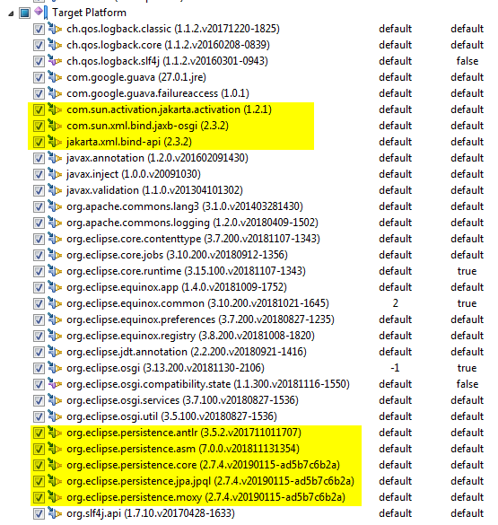

Re: Moxy Java11 [message #1804249 is a reply to message #1804247] Thu, 21 March 2019 08:27 Go to previous message
Frank Benoit is currently offline Frank BenoitFriend
Messages: 179
Registered: July 2009
Senior Member
here are plugins selected when starting with J11:
index.php/fa/35100/0/
Frank
